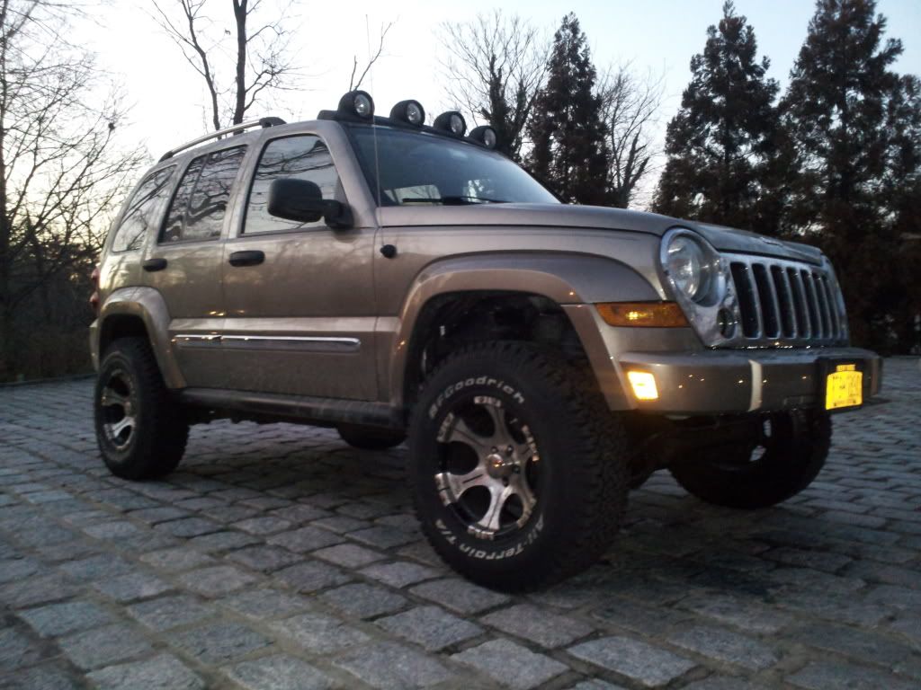

So after 4 long months the jeep has graduated from being a soccer moms grocery getter and is now worthy of its first pic post.
05 CRD Limited
GDE Hot Tune
Samco CAC Hoses
OME 790 and Bilstein 916 up front
OME 948 and OME N132L in rear
245/75/16 Treadwright Warden A/T on Richard Cepek DC-2
Euro torque converter
Renegade roof lights
Pioneer Z110bt double din navi w/ reverse cam

how did you go about trimming your front bumper? i bought i utility knife for mine is that strong enough to cut through the plastic?
 Post subject: Re: Finally respectable enough to get a pic up
PostPosted: Thu Feb 09, 2012 10:55 am
Joined: Mon Sep 26, 2011 4:35 pm
Posts: 178
Location: Brooklyn, NY
I marked my lines off with electrical tape and then followed the edge with a dremel cutoff wheel on the lowest speed. If you go higher, it just melts the plastic. I would go half way through in about 6 inch sections to make the line nice and straight, then i would go back and finish the cut through. There was a section on each side where the wheel was too small to go through. i used a sawzall metal blade and my hand to cut through. I kept the cut further from the finished line because it was a rough cut. When it was all off, i went back in with the dremel sanding wheel to clean up the edges. I'm thinking i should co back in and clear coat the edge and polish it out before the factory clear starts peeling up from that point.

if it's not too much to ask, can you possible post an under-bumper shot? i just want to make sure i don't mess up when i cut... i can't destroy my bumper haha

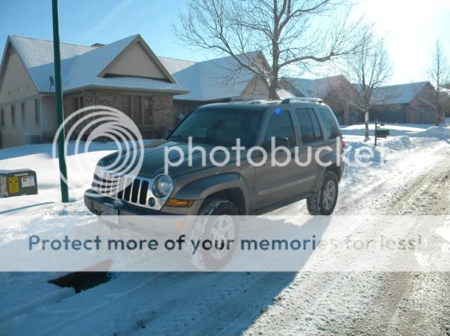

Here's mine..
By daveinliberty at 2012-02-06
2006 Liberty Sport CRD
GDE FT ECO/HOT Tunes.
OME 2.5
265 70r 16
SC Bumper
Glass Pack
Provent
Dodge 2500 in tank Lift pump
Samco Hoses
Rocky Road UCA
Transgo shift kit
Updated torque converter
Weeks Kit 1 & 2
