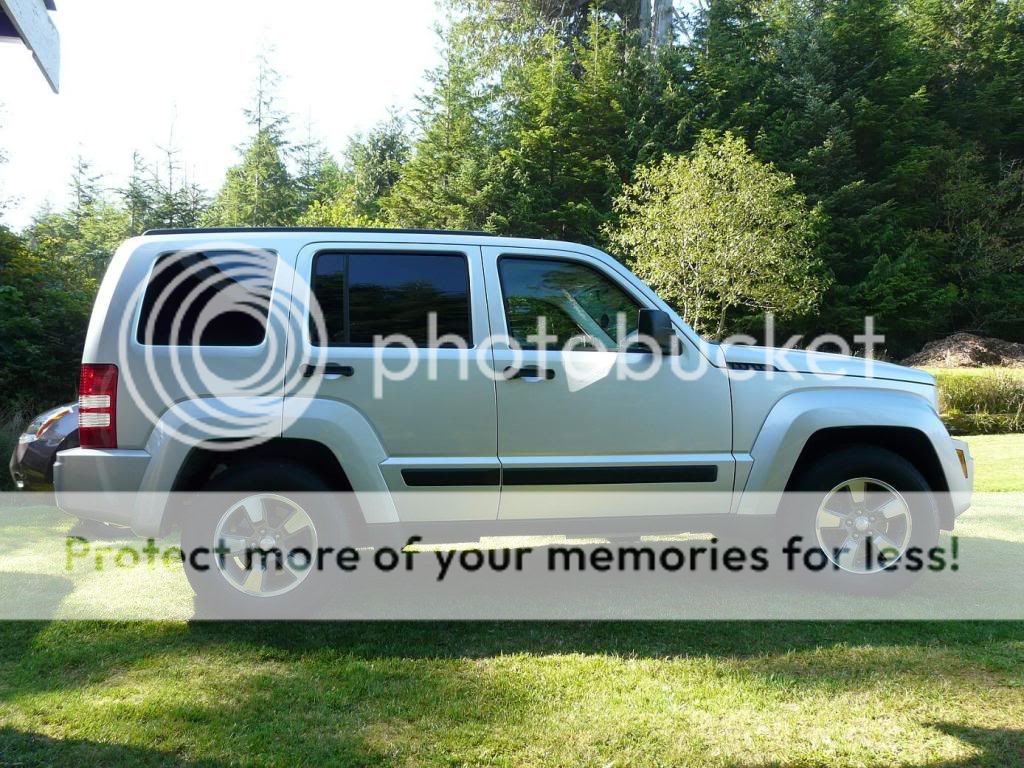

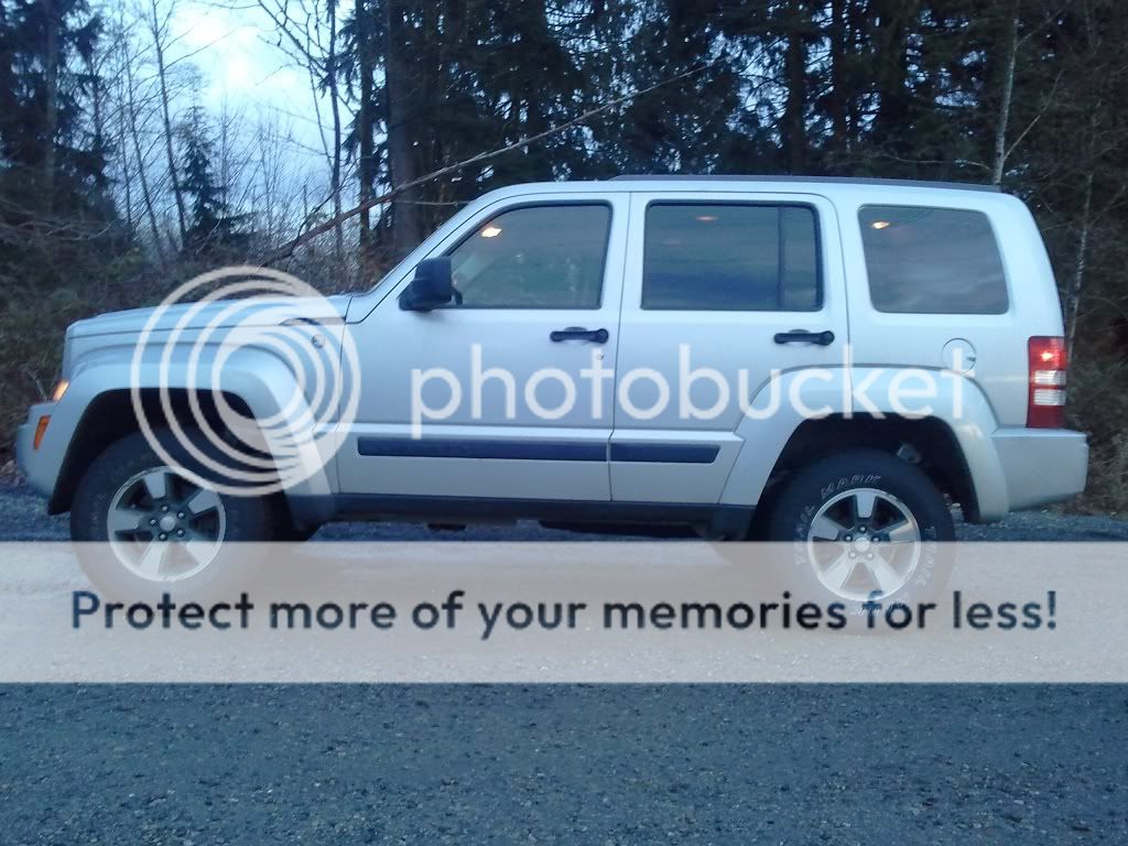

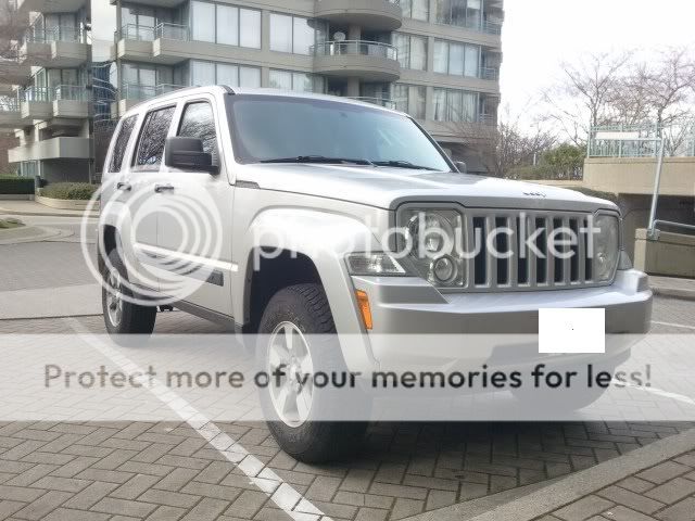

So after 3 long years, I have finally lifted my Lib :pepper: . I went with the OME 1.5 lift (HD/MD springs and the Longer shocks in the back) and measured about 2.25 inches of lift. I did NOT install top plates or spacers.
Thanks to everyone on here who gave me good advise and great suggestions, you know who you are :D
I am very impressed with the ride, it feels a lot more planted and firm especially on uneven bumps and potholes.
While the lift is not big, it is higher and more importantly to me, levels out the front.
Anyways..here are the pics.... taken with my cell.
Keep in mind that the tires after the lift are a little bit bigger so the space difference from the top of tire to wheel arches might not look as significant after lift. (And yes I did measure the lift gains taking into account tire size difference....and still got 2.25 inches)
Before (225/75/16 stock tires):
After (235/75/16 AT tires):

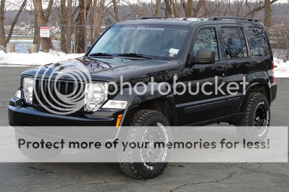

Quick question for anyone...Any idea what setup this liberty has ? talking about wheel/tire combo...and how much backspacing? (i know it has the RK 3.5 on it which i heard is closer to a 2 inch lift)
I remember seeing this on here before but cannot track down the thread through the search option...
THIS is approximately the look I am going for as far as tire and wheel combo height and width goes

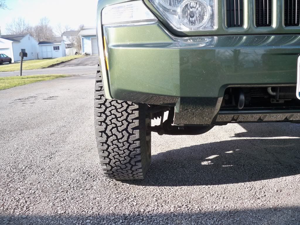

Looks good, I have the exact same set-up that kjon mentioned (4" backspace with 245/75/16 with an OME lift). I ran into issues with rubbing with that set-up, and added some conduit nuts up front for another .5" to help, and I trimmed my front bumper as well. I still get rubbing under compression sometimes so keep that in mind. This is the only real picture I have of how much it sticks out (I've trimmed more off since then to make it look cleaner).
If I were to do it again I would do what Dirty KK is saying by sticking with the stock wheels (and powder-coating if you want black). Between my steels and my load range E tires my MPG have dropped considerably (average 13-14 mpg).
