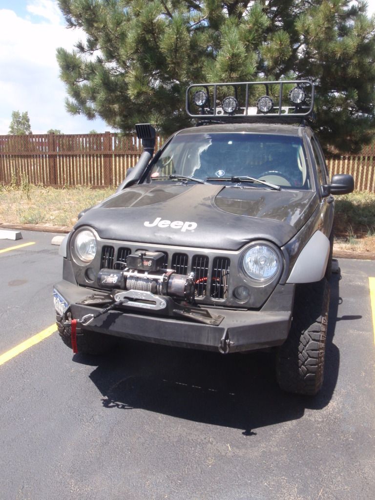

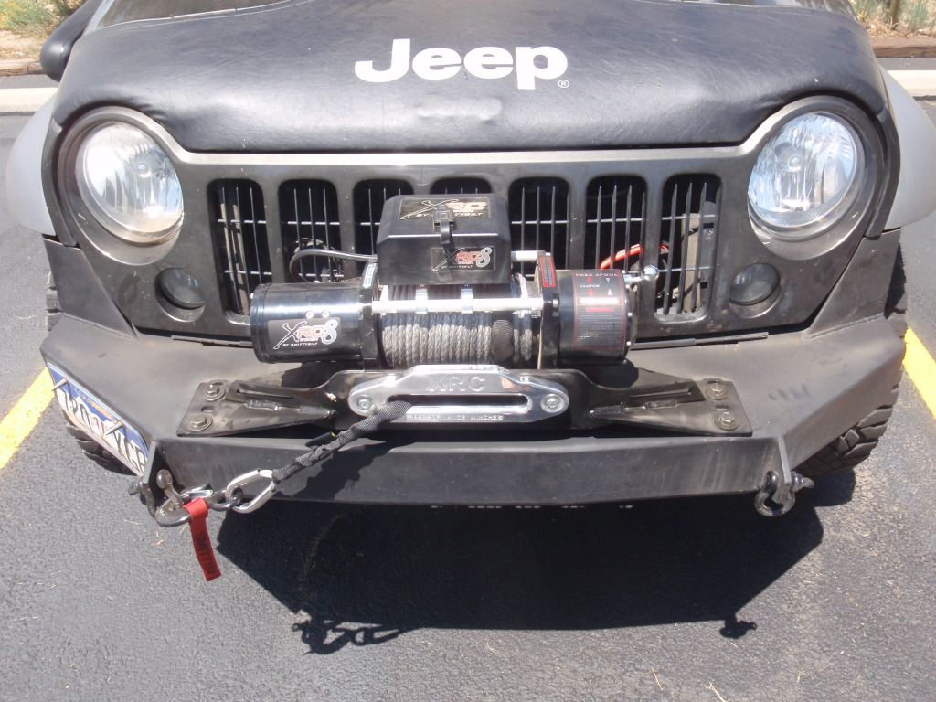

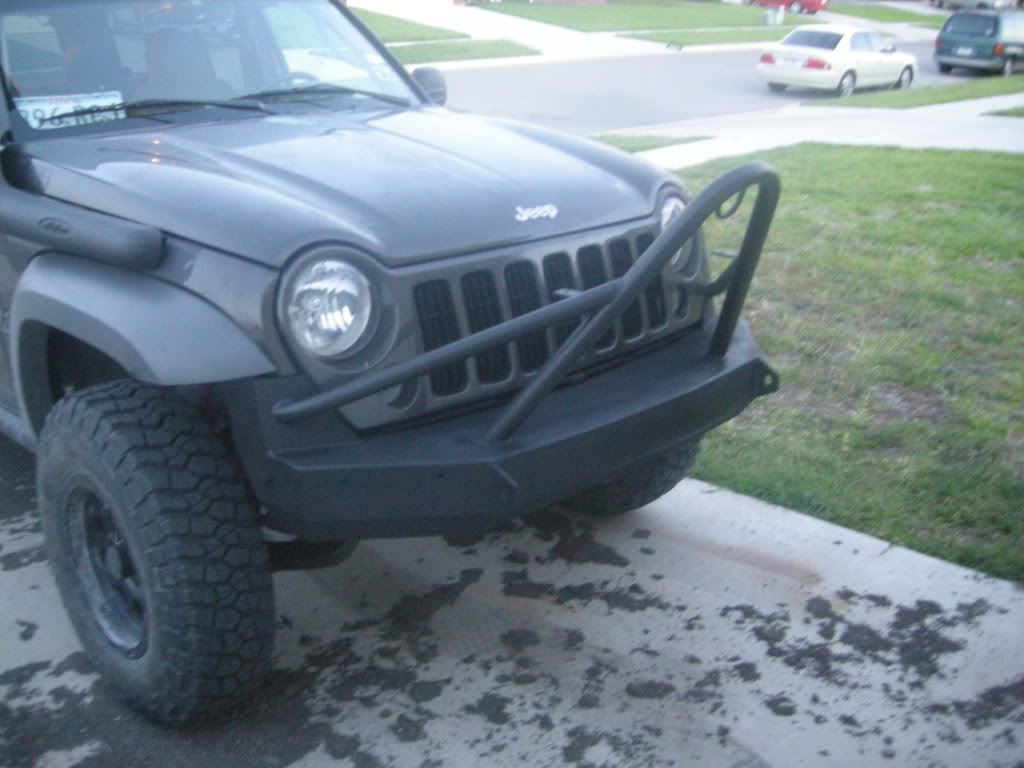

Many of you may remember the bumper on my rig with the big stinger. Well it turns out that it wasnt compatible with a winch. The stinger was right where the winch plate need to be bolted down. After all day cutting and grinding the new winch went on with out any other problems. I think my rig/bumper looks a lot better with out the stinger and with the new winch. What do you think?

Looks good!

Looks better!

Noooo! That stinger was awesome!
Why didn't you run a flat winch plate, cut that down, then run a 3/16 x 6 plate underneath the bumper to spread the load to the mounts?

You know.... never thought of that. We tried just about every winch plate and the stinger was always in the way. I wish I didnt have to cut it off lol... it would have saved alot of time.

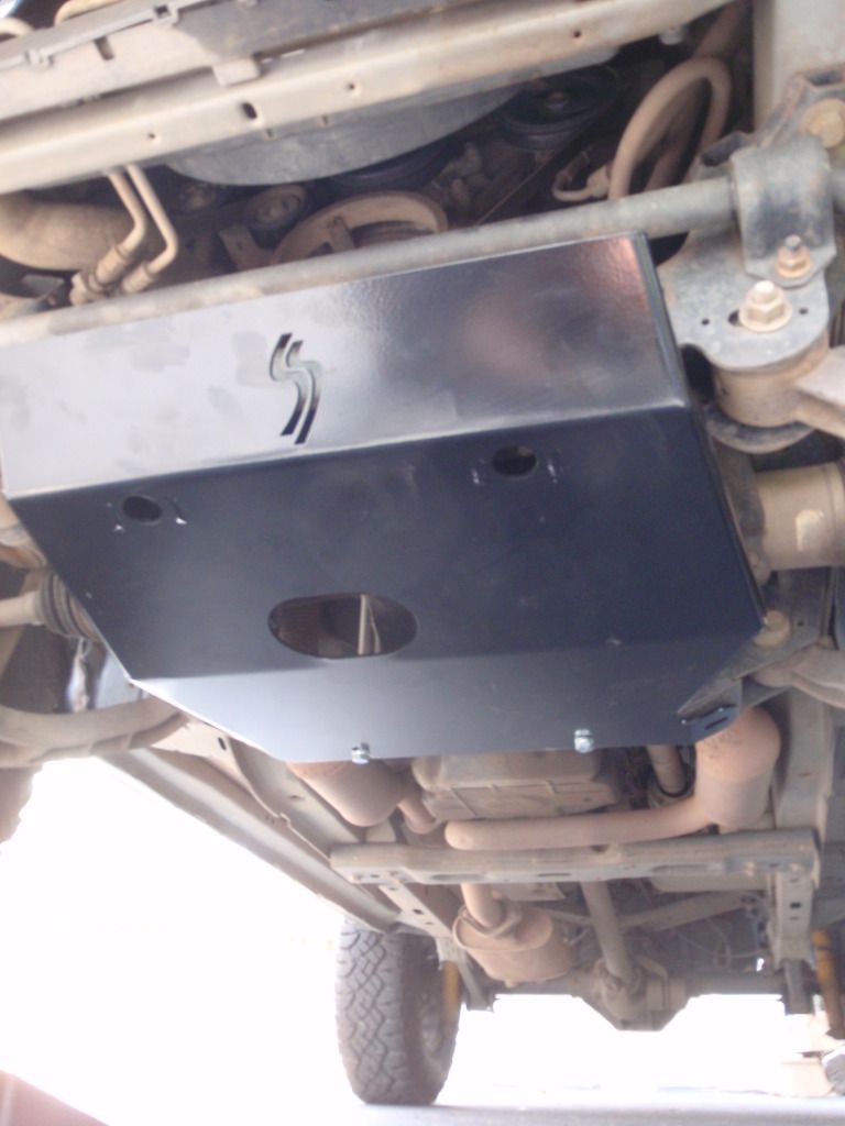

So I got the first plate in and installed.... just waiting on the others as well as a Rock Lizard gas tank skid.... I get the first one :D

Looking good!

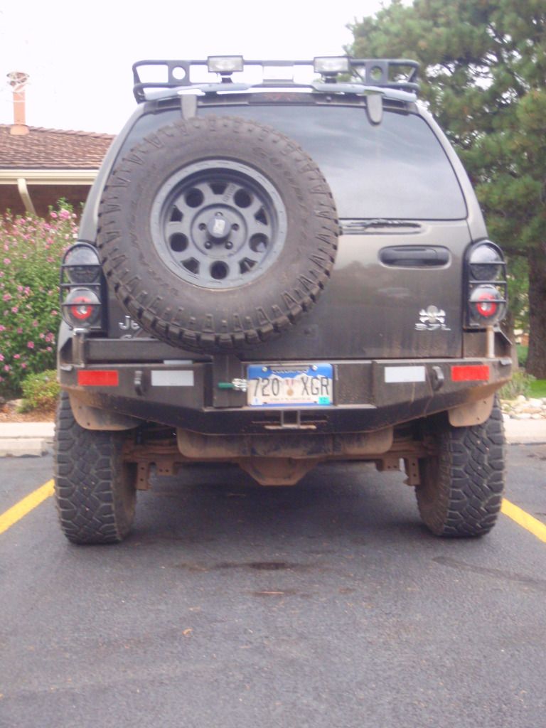

So its almost complete. I got my RL rear bumper and super skinks installed on my rig now and it looks great!! Im just waiting on my custom jerry can x2/ hi lift carrier and it will be complete. Well not really.... Im going to add an extra ISO in the rear and add another 1 inch of lift in the front. What do you all think?

Good install, yours looks A LOT like mine now! I need a snorkel and duratracs to catch up!
