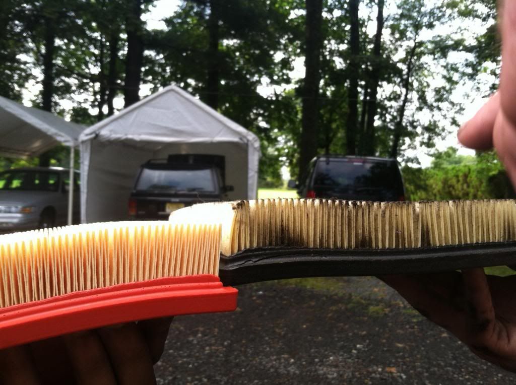

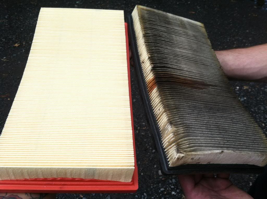

That air filter's pretty danged nasty :shock:
2005 Liberty Renegade, Bright Silver Metallic
 Post subject: Re: A Day With An XJ.
PostPosted: Thu Aug 29, 2013 8:22 pm
Posts: 3278
Location: Jersey

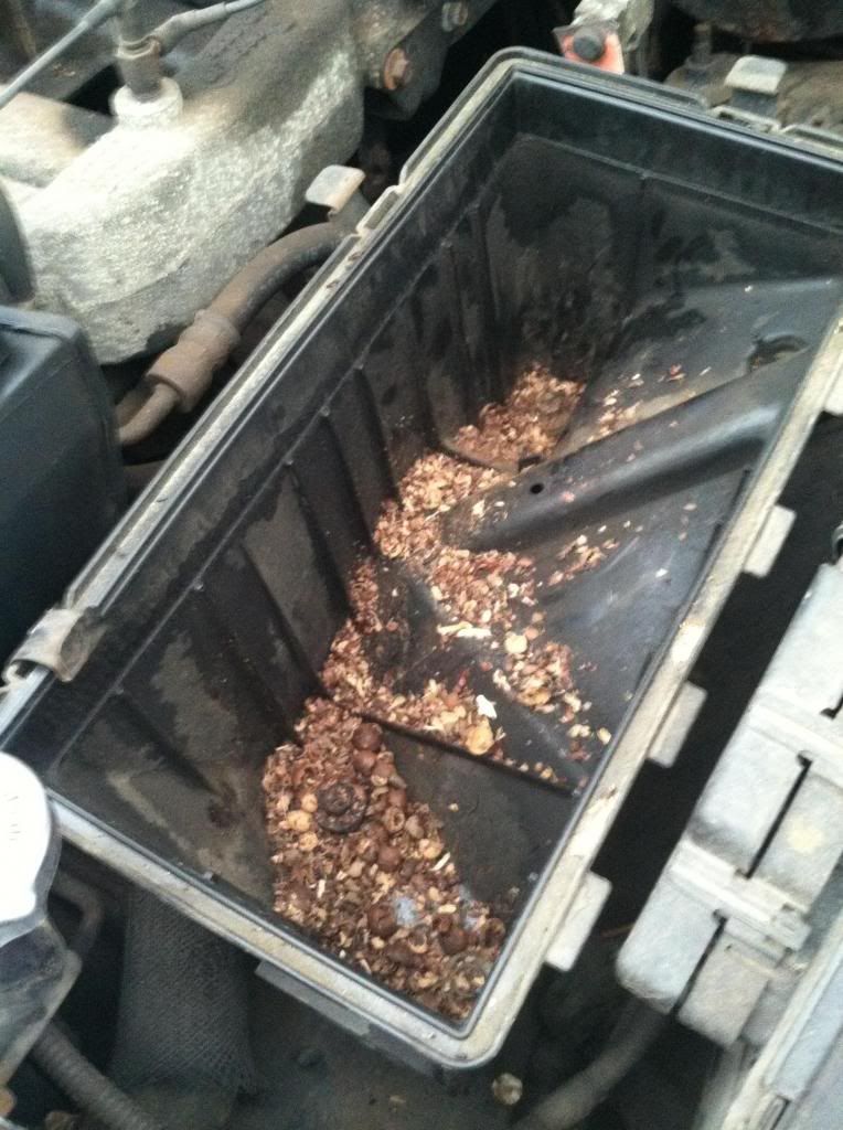

I know, right! You should have seen the throttle body! I cleaned that as well. Runs like a real champ now. 165K miles. I doubt the throttle body was ever cleaned before. We also gave it a synthetic oil change.

With the filter that dirty, I believe it.
I assume it was pretty gunked up.

There were like 100 acorns in the airbox. :roll:

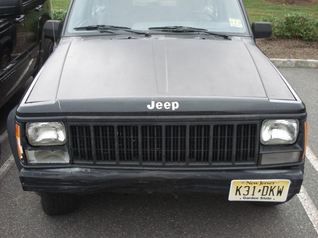

Please notice the plastidipped hood.

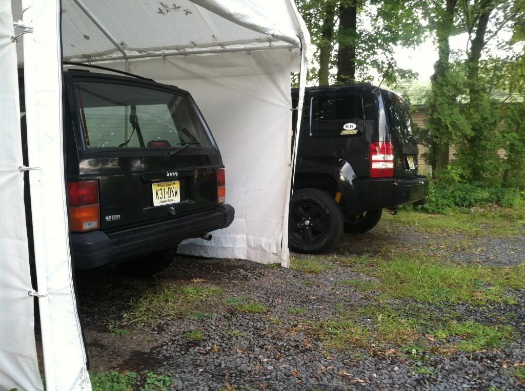

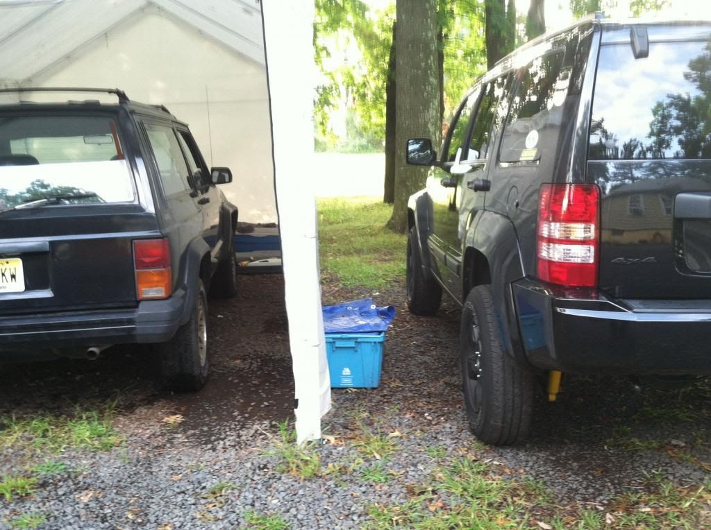

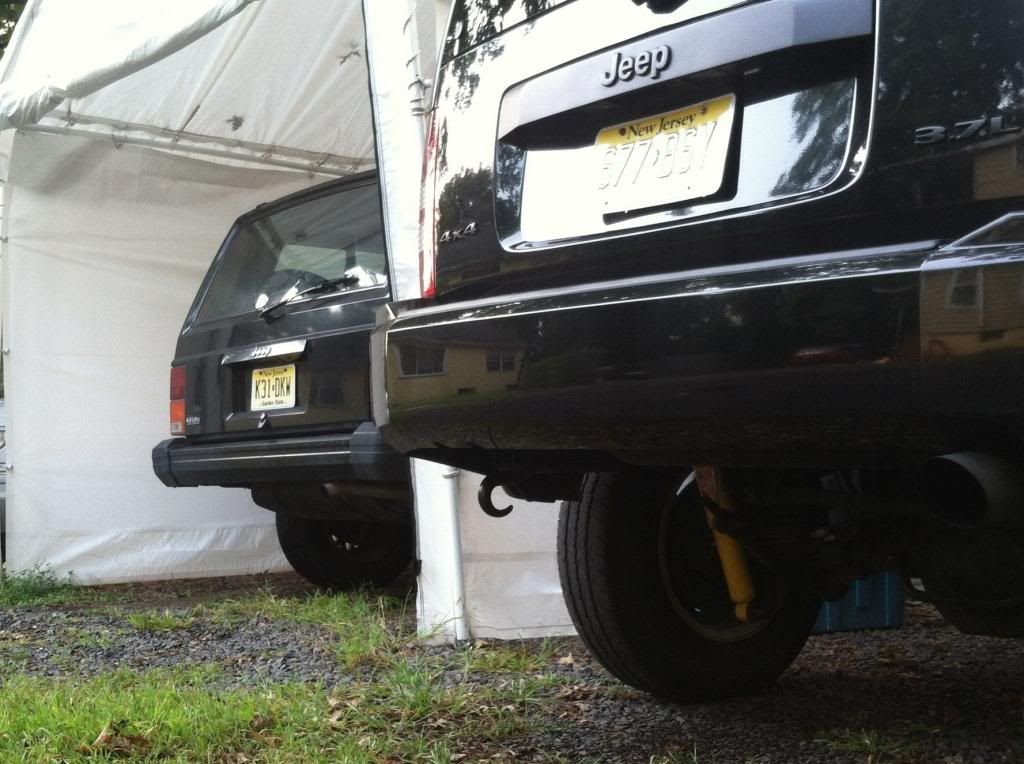

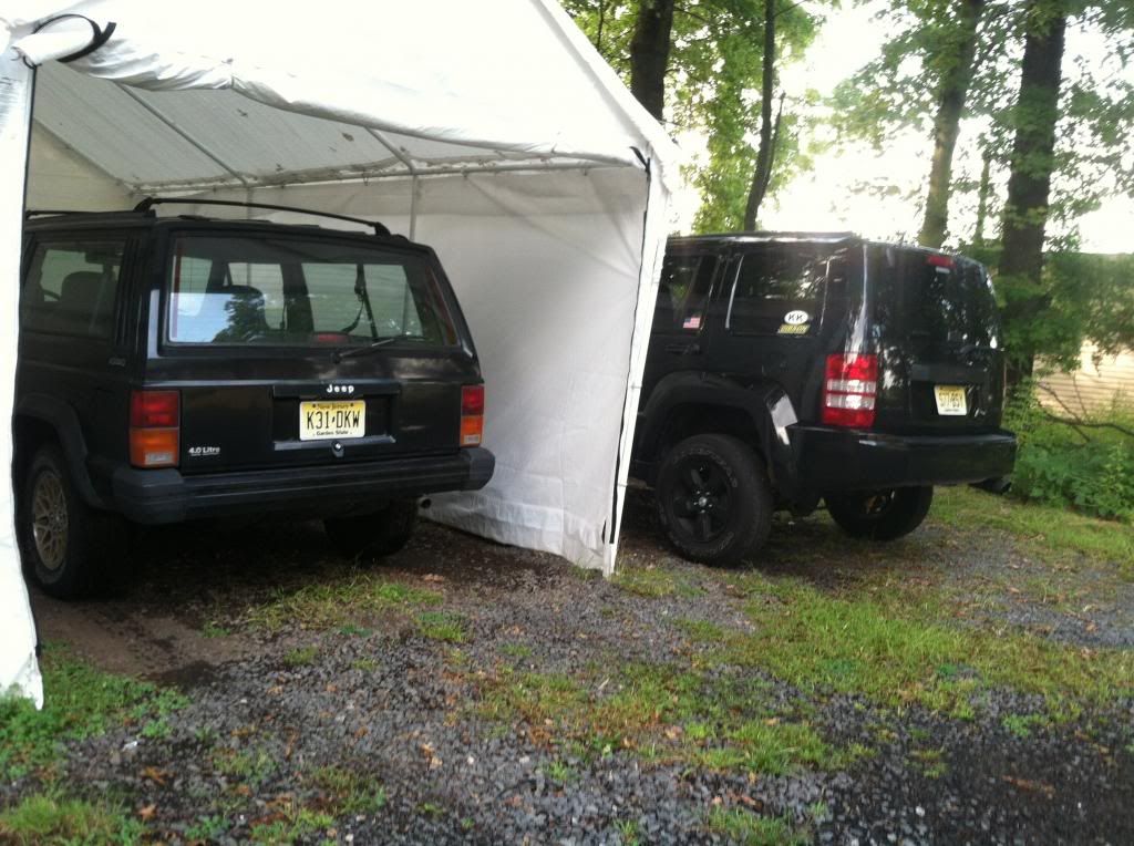

KK's are a lot taller than XJ's. Having owned both, I appreciate having the extra headroom. That XJ needs a lift to park next to yours though!

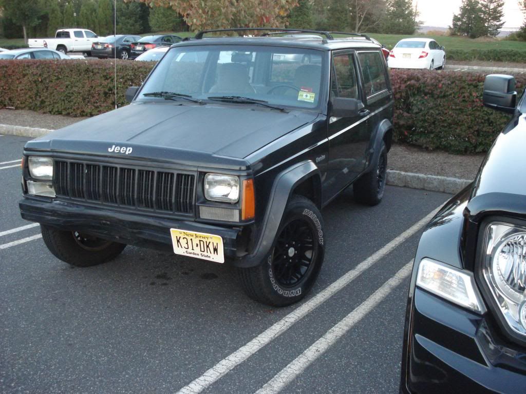

You should have seen the XJ I saw parked next to a KK today head on. The XJ was lifted 6 inches or so and huge tires, defender rack, extra lights, steel front bumper, etc. head on with a stock sandstone color KK lol.
The XJ needs more work still. Gotta replace a few grommets on the valve cover and fix the parking light that is cracked.

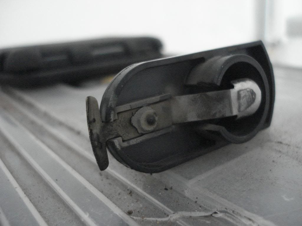

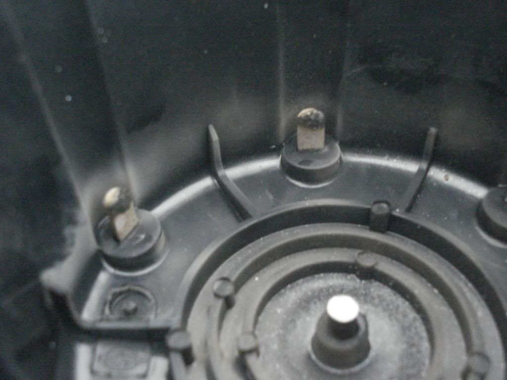

The XJ failed inspection the other day. In New Jersey, all it has to do is pass emissions. It failed the idle emissions, but passed the high idle emissions.
Armed with that knowledge, we decided to throw some more parts at it. First thing was to inspect and replace the cap and rotor.
Take a look at how bad this I believe original cap and rotor were.
After that we also replaced the spark plug wires since we did the plug a couple of weeks ago. The last thing we did was clean the idle air control valve. Man was that thing dirty!
I believe it's getting taken to inspection tomorrow and hopefully it'll pass!

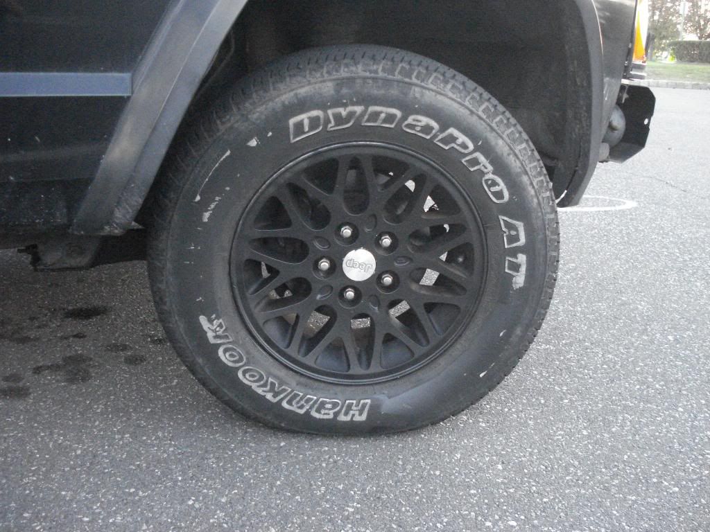

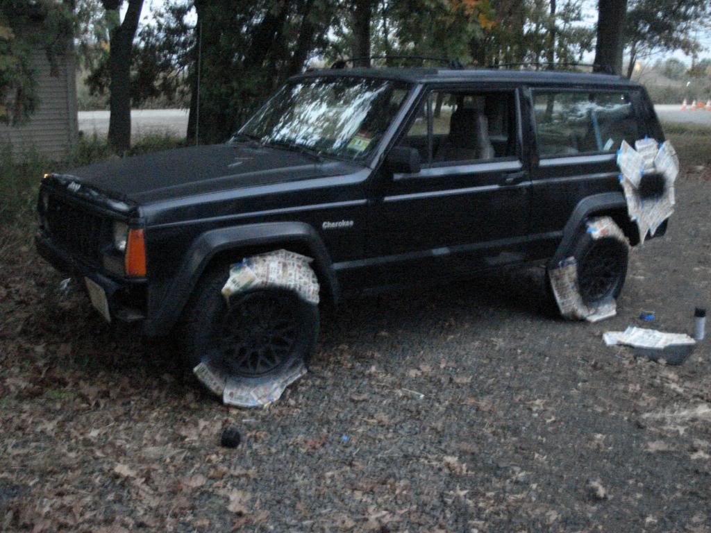

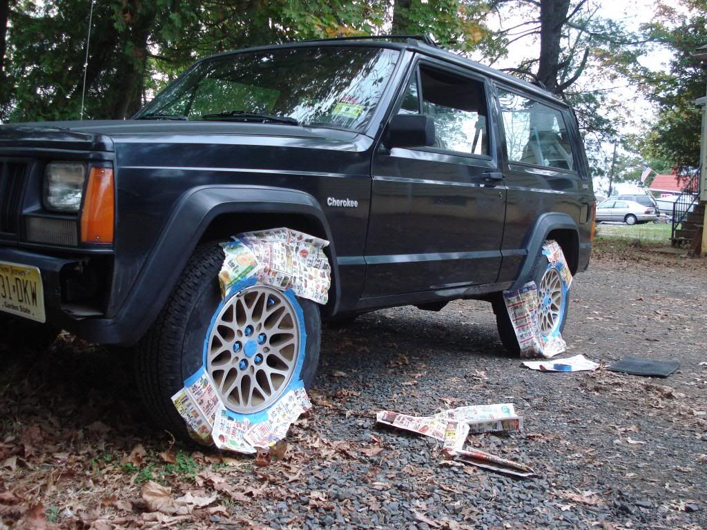

Some more updates. We plastidipped the wheels and gas door on the Cherokee.

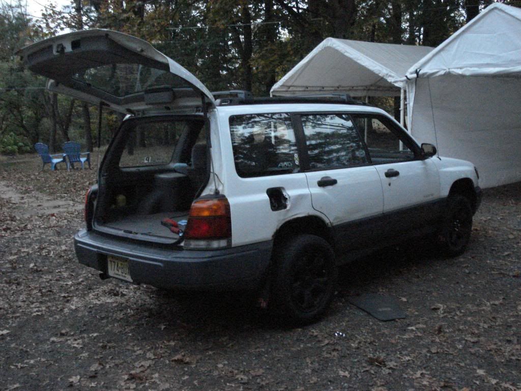

Also repainted my friend's Forester rims. They were red, but decided they looked better black.
