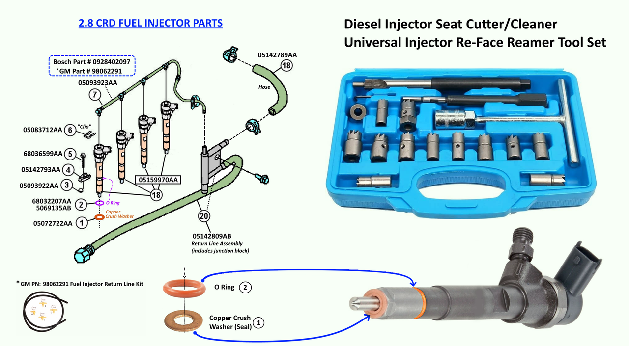

The injector seal is a copper "crush" washer that fits between the injector tip and the cylinder head. There is also a rubber "O" ring on the injector, but its purpose is to keep any trash out of the injector pocket.
See Picture 1
If the metal sealing surface on the head needs to be resurfaced, there are small face boring bits available online for cheap to perform this with. Just don't get to carried away cutting the metal when resurfacing.
Shown in Picture 1
You can find them online if you search for:> "diesel injector seat cutter" :google:

In the diagram a orange o ring is shown situated halfway ish down the injector shaft but I can’t seem to find the correct one available and the jeep dealer suggests that it may not have them on the 2.5 as they can’t seem to find any info/part number. Is this just a feature on the 2.8?
 Post subject: Re: 2.5 CRD injector settings
PostPosted: Tue Feb 07, 2023 2:45 pm
Posts: 7403
IDParts has the seals:
https://www.idparts.com/injector-seal-r ... -3284.html
Part Numbers on diagram:
Seals:
