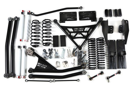

It has 6.5" Iron Rock Off Road long arm lift, dual steering stabilizers, drop pitman arm, adjustable track bar.

I believe this is the lift it has: http://www.ironrockoffroad.com/Merchant2/merchant.mvc?Screen=PROD&Store_Code=IROR&Product_Code=IR-W_6LK&Category_Code=WLK
The lift has a "Y" drivers side front control arm and a single passenger front control arm. The track bar seems to be at a pretty steep angle, the pitman arm is a drop down and so the steering arm (not sure what that is called) has less of an angle than the track bar.
