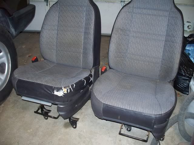

Ok, moved on to the next items on my to fix list.
First up the new seat. The old one was in bad shape. Seems like I am sitting 2 or 3 inches higher now.

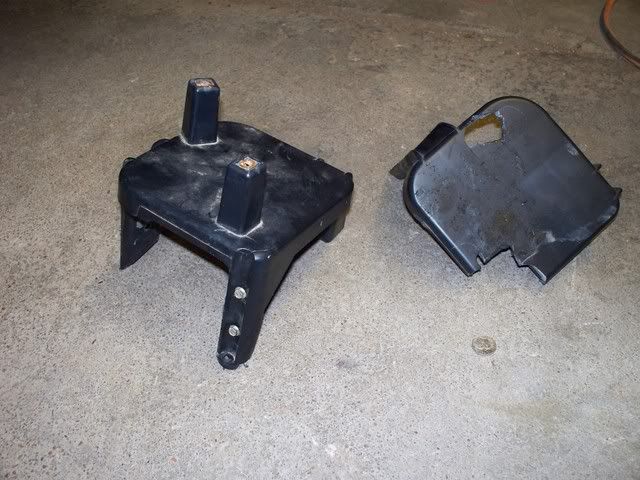

Then the console mounting bracket in the back was broken.I looked in three different XJ's at the salvage yard and all of them were broken so a picked up the one that was in the best shape. I took the two brackets and made one good one out of them with a couple of screws and some epoxy.

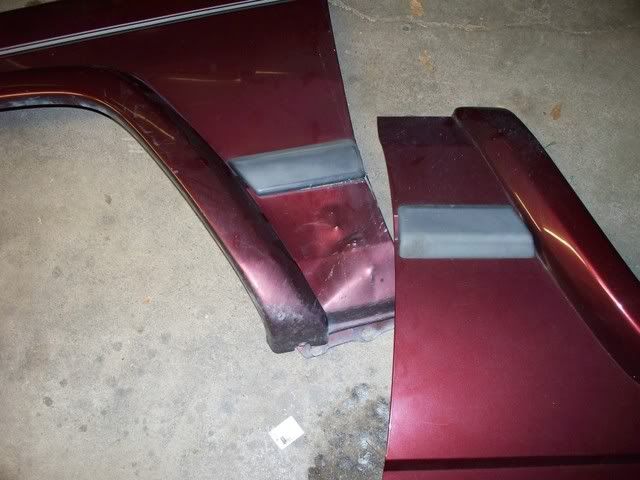

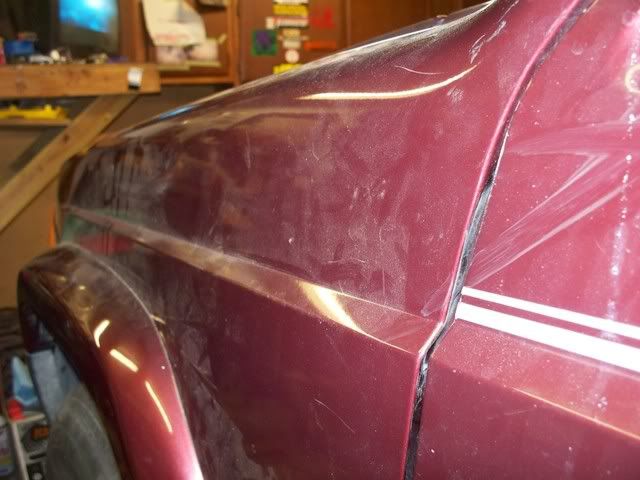

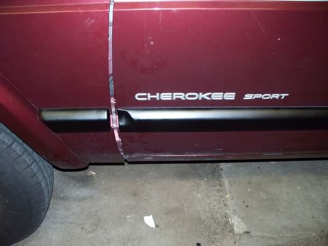

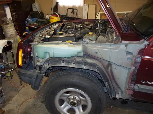

Next was the fender
It all matched but the new fender did not have the pin striping,
Next week I am planning on installing the door pins and bushings and getting the pin stripe done.

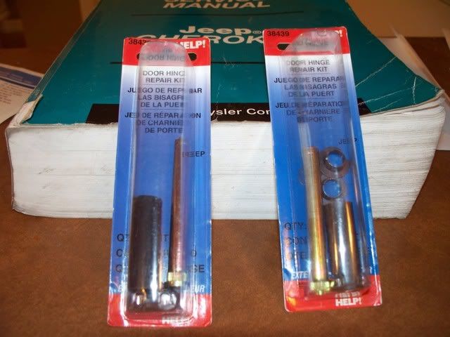

Just ordered my hinge pins and bushings, for a 2001 made by dorman part # 38439
Sounds like they will be a pain to install as far as I may have too grind out the old ones. :frankie:

Door Pins and Bushings came in today. 8)
I am going change them out this weekend. From what I have read you grind off the head of the pin apply some heat and knock it out with a punch and a big hammer. I hope. :lol:

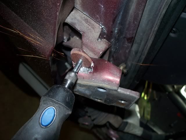

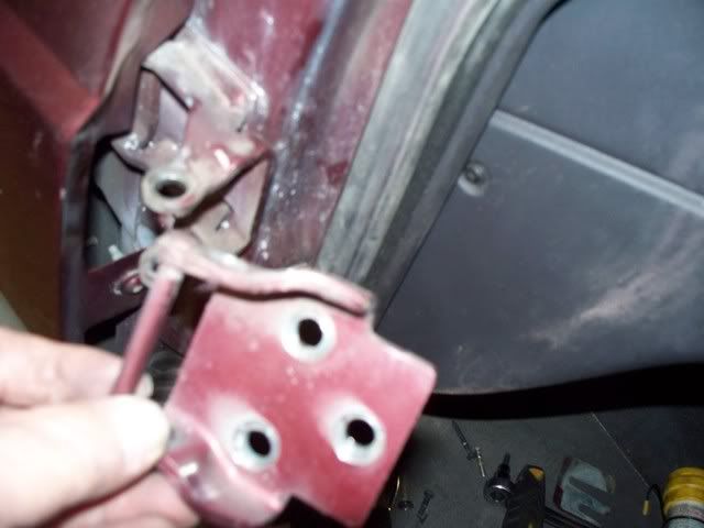

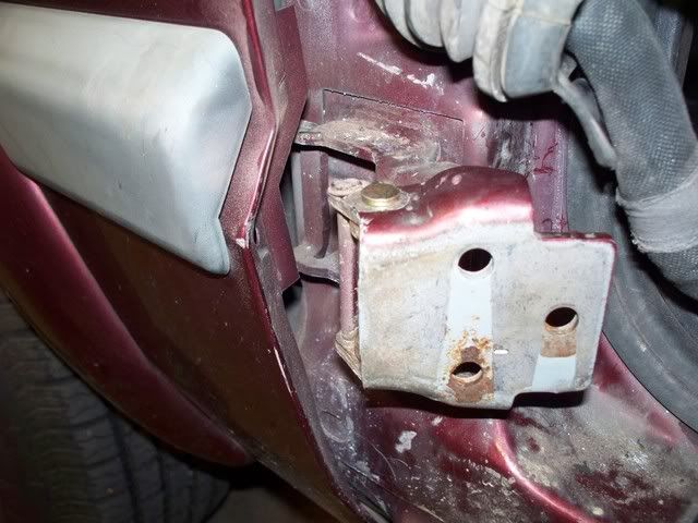

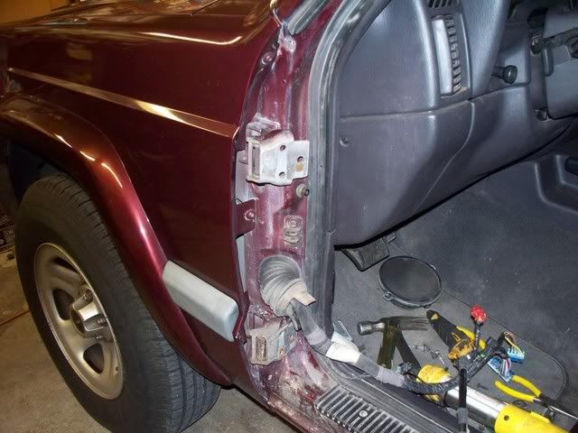

Got the new door pins and bushings in. Door came off fairly easy,I used a jack to hold up the end since I was by myself.
Used a dremil to grind off the top of the pin.
I was surprised It only took about ten or so good hits with a hammer and punch to get them out. Did not even need to heat it up.
Then installed the new pins/bushings. It was much easier than I thought it would be.(for a change) :lol:

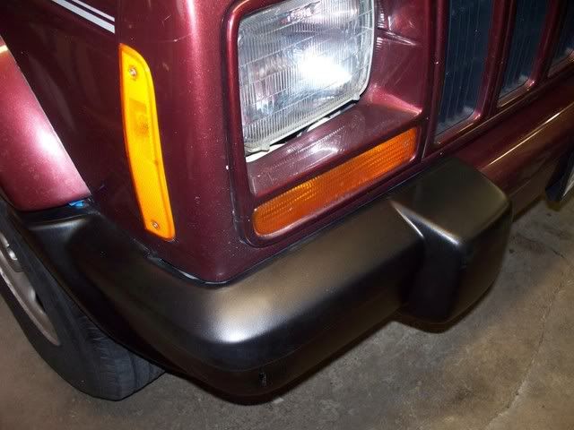

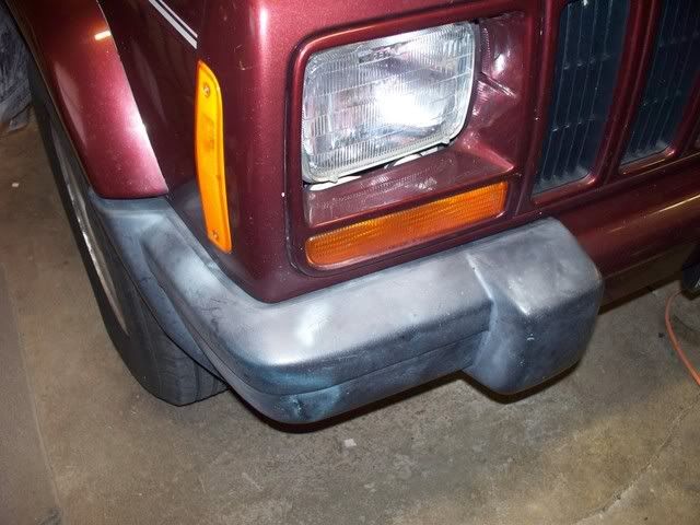

Repainted the bumpers and trim this morning they had turned into a grey color.(can you tell I'm bored) :lol:
