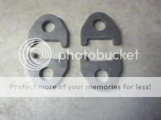

On to the driveway mods I have done in the last few months...... I got some weld on shackle tabs from Rusty's
and drilled holes throgh the bumper for the weld tabs to stick through and welded front and back, then added a 3/8" x 1" by 6"L support behind the bumper to reinforce that section
I got hold of some 3/4" pin 13K rated shackles for those.

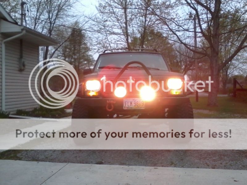

Then, let's see, what was next ....... I didn't like the bare look of the front steel bumper, so I got a piece of 1.75" dia., .180 wall tubing and got it bent and fit and welded a stinger on.
I also got a 1/2" nut and drilled a hole in the top of the bumper and welded the nut underneath to provide a spot for my flag when I go to the parks. I threaded a bolt into it with neversieze to keep the threads from rusting up when it's not in. You can see the silver bolt head in this pic.
I also ran to Autozone and picked up a couple cans of hammered black for the bumper and stinger and even did the grill and headlight bezels. Then decided to rattle can gloss black the hood and front fenders that had been changed at some point and never painted.
On 1 of my trips to HF I picked up some of the CHEAP $15 driving/off-road lights they had on sale and have those mounted to the bumper and am now running those off the factory driving light switch.
