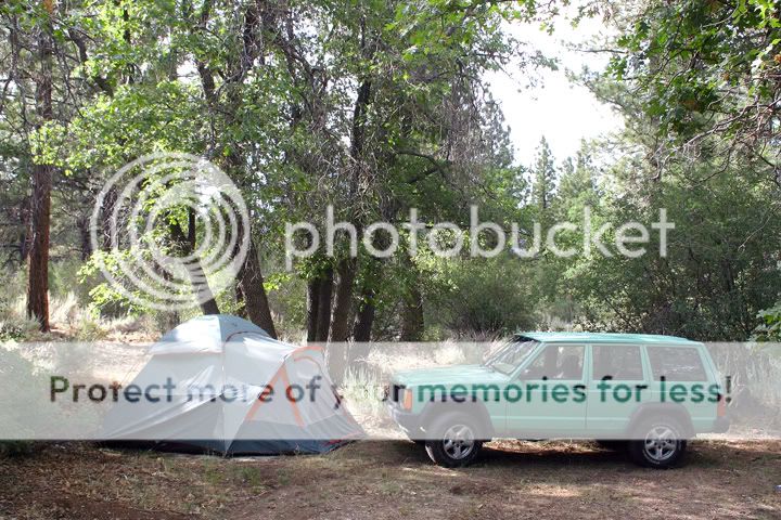

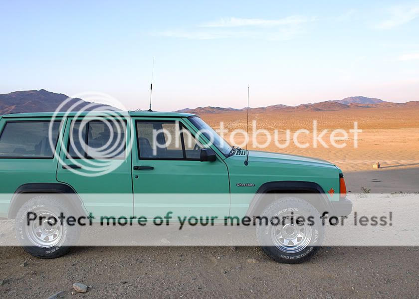

Hey Guys, Sorry I was gone for so long. Here is a little update on the XJ.
Well, we went camping.
Did a little wheeling.
I found some used shocks for 40 buck, and some tires and rims for 40 bucks too. Then more camping.

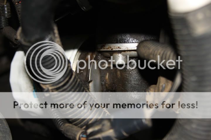

Then I had a massive oil leak.
Got that fixed.
Then did some more wheeling.
So far I've put 1K miles on her, and so far so good. Mechanically, every thing it running find. I have a little engine "stumble" when wheeling while pulling up hills. Just use 4 low and it pulls right up. shut her down for about 5, starts right back up and runs great. I can't get it to repeat the problem again, and it's only done it to me twice.
