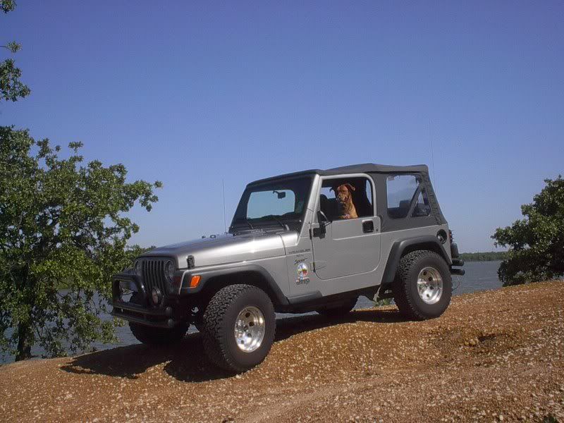

PostPosted: Thu Jul 20, 2006 12:25 pm
Joined: Sat Jan 07, 2006 12:17 pm
Posts: 29
Here is a photo of my Jeep long ago when I had the 31's on it. (back before the lift ARB's gears, fron ARB bumper and a whole load of expensive stuff!
