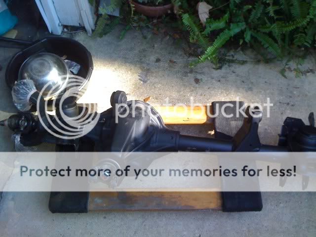

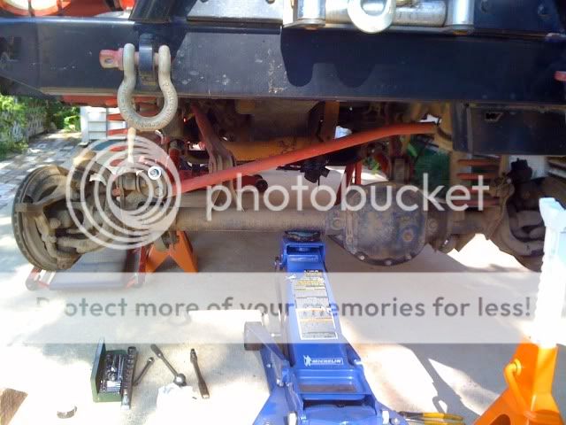

Some pics. of job

PostPosted: Mon Jul 27, 2009 10:39 pm
Posts: 1776
SOOOOOOOOOOOOOO much beefier.Can't wait to get the backs bolted up.
