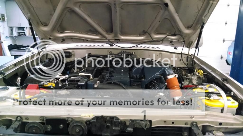

Question about your intake manifold. Does it sit higher than the stock one? Been thinking of getting one but I don't have anymore room or it will hit the hood. I already had to cut a small 1" square out of the hood support to clear the stock one.
This particular manifold appears to be the same height as stock. If you look at the top picture, you will see the OE manifold supporting the oil dipstick tube. If you look at the bottom picture, you will see the aftermarket manifold also supporting the oil dipstick tube in it's original location. It is very well designed.

That's awesome news. I want to move my boost sensor onto the intake horn for better readings. You can see in the pic where it was "kissing" the hood.
