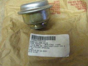

3. I also ordered a cap to replace this:
The vent hose has seen better days.
The cap I ordered, from an Ebay seller:
