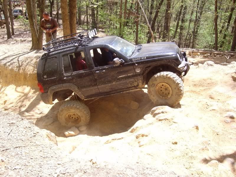

was going through some pics and thought i would post this one...it's one of my favorites...lol

You make me want to finish mine more and more every time I see your jeep. :D
