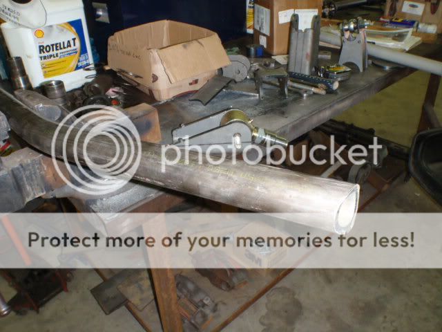

I had to reintroduce myself to the CRD. Been away for so long I couldn't remember what I had planned. I had minimal notes on what i had laid out. But it came back quickly as I repositioned the front axle under the tight working space. I have been 4WD for a while and have built a few, but not a coil spring, contol arm set up. leaf spring rigs are really simple in comparison, especially when you can use a full hyd. steer. I spent Sat afternoon replotting and this morning started with building a tyruss for the front D44.
Accidently cross threaded a fine thread bolt. Dang short vision.
Next, started on the control arm using 1 3/4" X 1/4" DOM with a slight bend where the upper arm will tie in.
Tack welded in place until a final articulation check. This is fun stuff, don't know if I'm doing rite or wrong. thats apart of the challenge, if wrong I can beat it down and start all over. LOL
I hope to do more after work manana. I'll post some more.

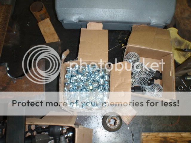

I have been busy with work, so, not much work has been done on the CRD. but I have been ordering more parts and some specific tools for installing the gear sets and ARB lockers.
I also ordered a set of wheels and tires from a local shop. when i went to pick up the set, an employee at the shop came out with a box that was taped up tight. He said this box contains the lug nuts for the set. I didn't ask if it was for a set of five or a set of four, I just had a picture in my mind that it would be the fancy lug nuts that come with aluminum wheels. I got the set of wheels and tires home and was excited about how well they looked, next I opened the box of lug nuts and wow! There was 200 nuts for 1/2" studs. LMFAO I was curious, I don't think I have anything on my property that has this thread. I know I don't, I went and looked. If any one needs any 1/2" lug nuts let me know. LOL

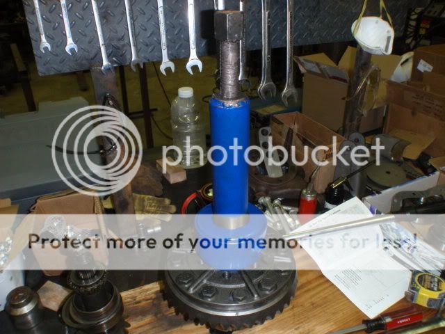

I started assembling the locker ring gear.
Had to build a spanner to hold the locker while the bolts get torqued to 110 lbs.
