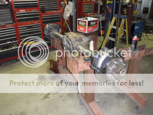

I did more work on the rear axle today, got hte ARB finished and found longer stud bolts for the disc conversion.
I ordered a truss from Ballistic, It showed up this afternoon.
Tomorrow I can start some welding and bracket positioning.

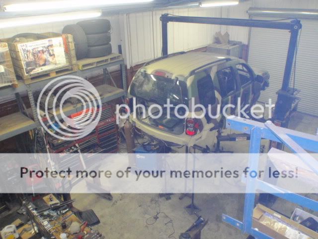

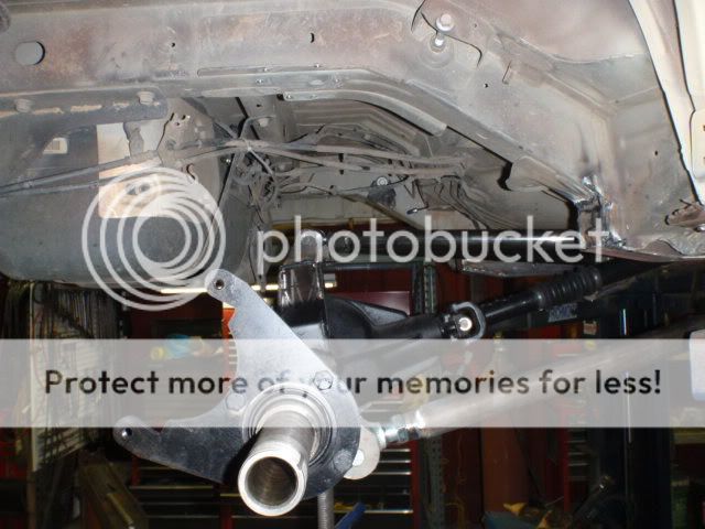

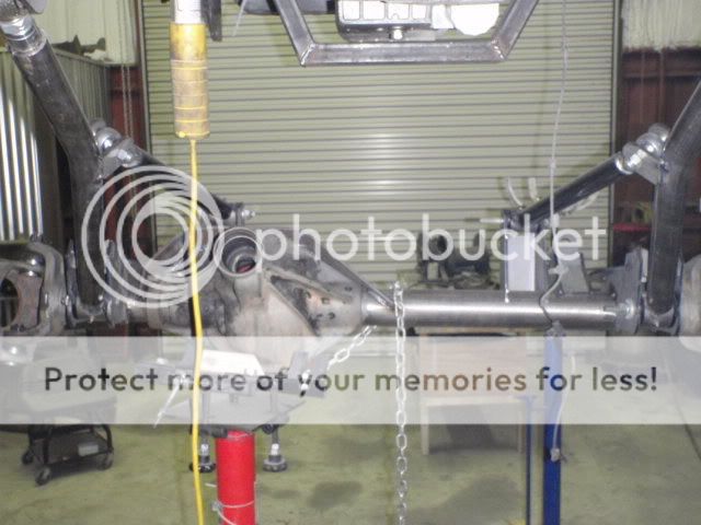

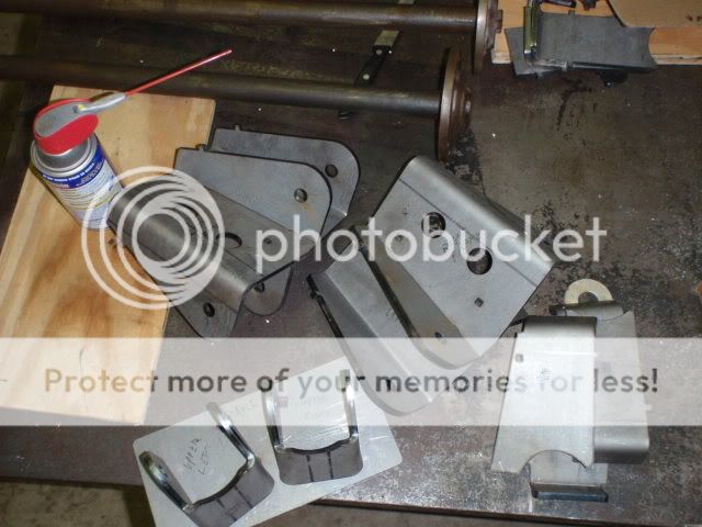

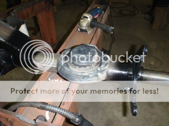

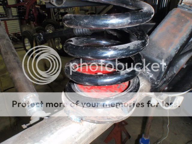

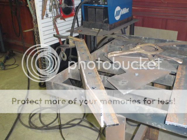

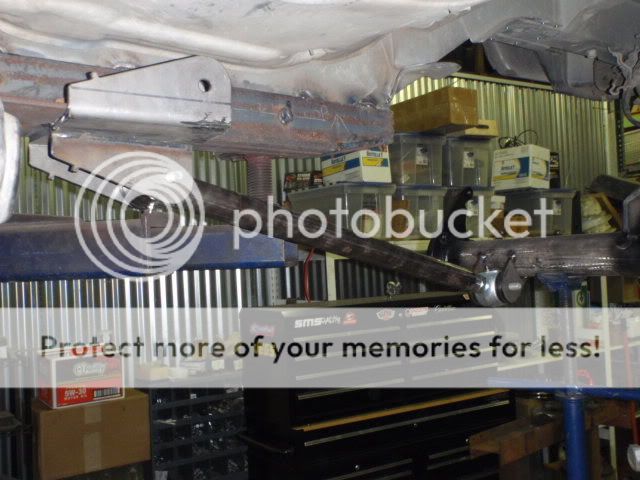

I started on the 4 link suspension over the weekend.
Reinforcment for the bracket.
Cut this off the stock axle,
A shot from upstairs.
A shot of the front. Drooping.
Front coil bucket.

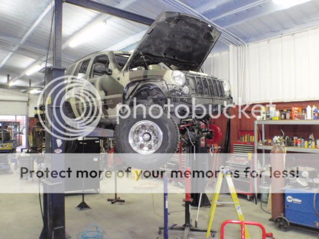

I had some time to put the front axle together, it took me a while to get all of the parts rounded up for the front axle overhaul. But it is together, 95%, I have to build the tierod.
Got the ARB in and shimmed.
Polyperformance had the Solid covers for $65 with a 10% off at a new year sale. couldn't resist.
Finally was able to put the tire and wheel on for a first peek and a clearance check.

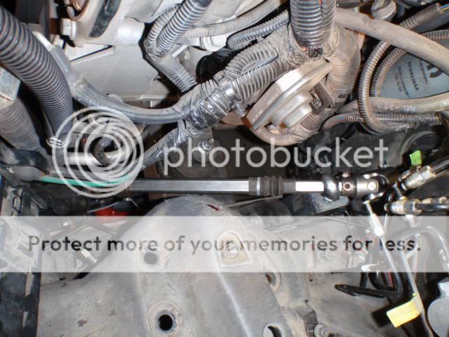

I think I have the steering issue figured out. The radiator hose is a pain to work around.

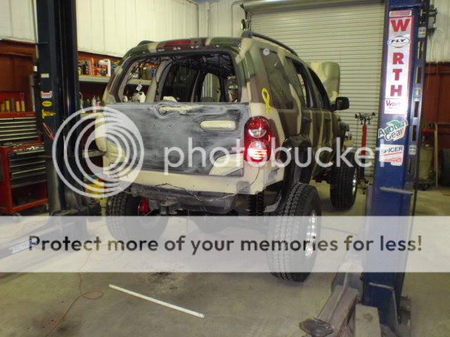

Back at it again.
I run into a snag about every other hour that i work on this project. Comes a time where I just walk away and clear my mind. LOL Stew on the problem for a couple of days and go at it another route.
Got the steering in.
Drag link.
Spring perch.
Modifying the spring retainer, one size fits all.
Inspection.
Approval?
I have the front and rear swaybars in and will get some more pics up maybe sunday nite.
I'm working on brake lines, sterring hoses, radiator hose and parking brake this weekend.
