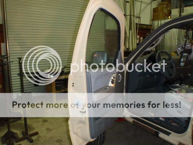

I did a little more over the weekend.

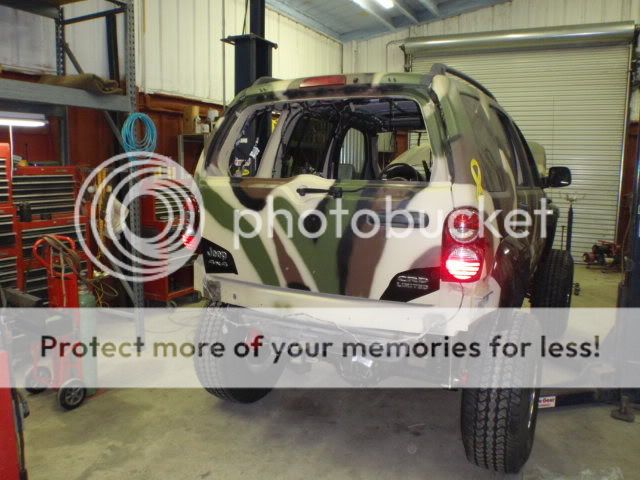

Got the original door parts intstalled, now the key and remote unlock is in line. That is tight working quarters inside the door cavity, trying to find the little clips that hold the levers and windows in place, required much patience.

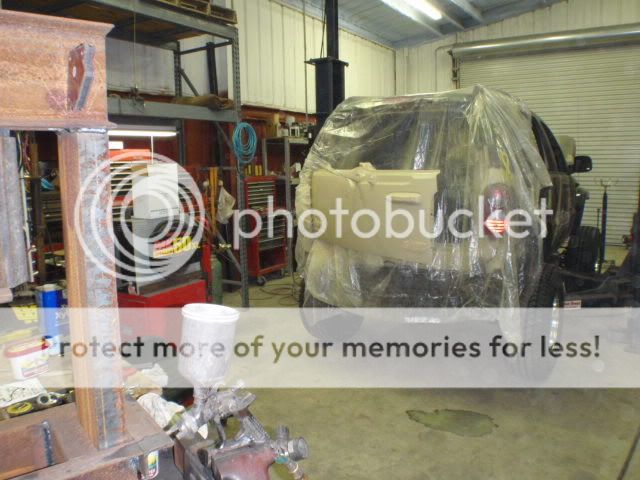

I've had the rear door ready for paint for a couple of weeks, finally got the paint on that. the tape reidue starts to become a problem.

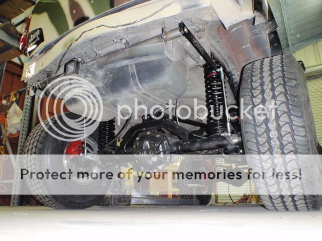

rear shot. the Currie anti-rock really rocks, wow what a difference.

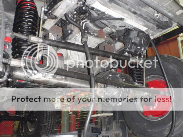

Front shot. Did not get the power steering hoses finished. Had to order more parts. Imagine that. LOL. $100 here $100 there, wow it adds up to a ton.
I have the front drive shaft dropped off at the local driveline shop to be lengthened.

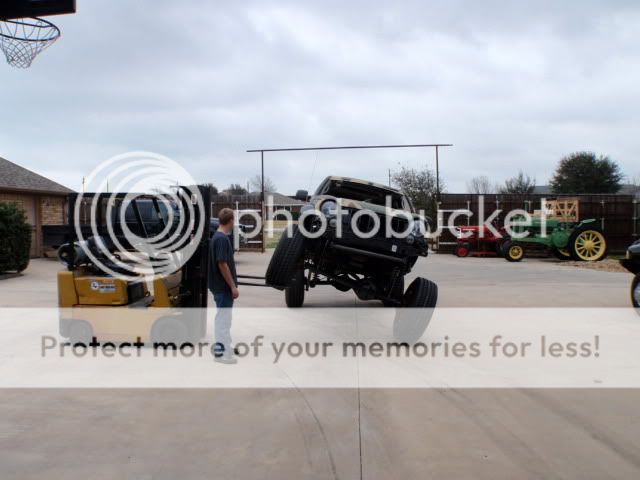

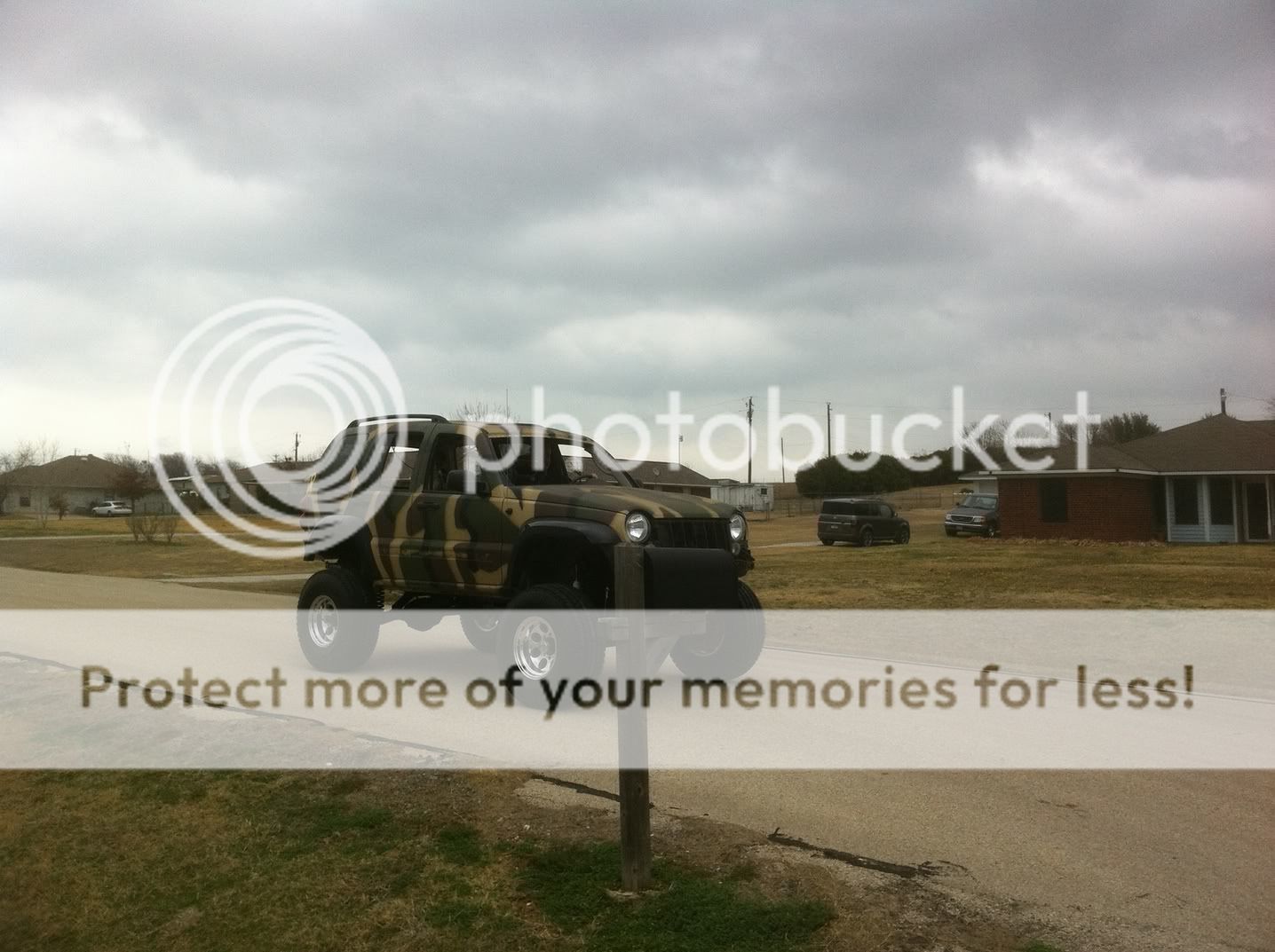

Got the small parts in, during the week. Drive shaft was finished on tuesday.

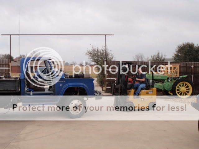

One problem I had was my son had his 65 dodge propped up on stands and I couldn't exit the shop to test drive the CRD. I had him up early this morning putting wheel hubs on his truck to move it to the other side of the shop.
First road test.
Its pretty flat where we live so Ethan did the fork test.
Then he went back to his project of fitting discs brakes on a 45 year old truck.

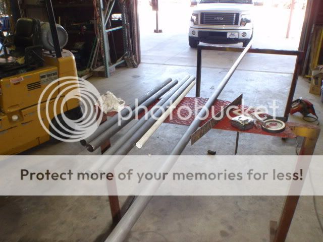

I started the rollbar in the liberty.
I 've also started the rear bumper/tire carrier.

The fork lift flex test looks impressive. How did it drive for ya? :JEEPIN:

The CRD drove good down the the street, the speedo doesn't work but went to fourth gear maybe 35 mph. Good smooth ride, the antirock and rancho rs shocks keep it from being a slinky. Steering is very easy and smooth, no binding or bumping on the smooth surface. I had to run the radiator hose up above the fan shroud instead of below, therfore i have to bleed the air out of the system. I've now ordered a sight window with a bleeder valve to hopefully solve a overheating problem.

Actually I didn't move the radiator I just relocated the hose that went across the bottom.
I cut the u-shaped stock hose and added couplings to alter the hose.
As for the speedo I'll probably do the rocktrac with a speedo port on the tailshaft.
I was watching XTREME 4x4 on Sunday and he was addressing that same problem but it didn't show anything. he made the coment that they were getting a part machined. LOL. TV shows don't know what a budget build is. What fix are you using on the speedo?
The ABS don't know yet. I took out the 2 fuses but thats all.
Rear triangulated 4 link seems to do good. no tracbar for that.
I'm not sure what you meant by flipped steering, I have used a stock ford box and stock arms on the axle. I did have the passenger side knuckle machined for a Parts Mike long arm. I also used a stock pitman arm with no drop.
In full drop and full compess with the front suspension, the front driveshaft has no movement in the slip yoke.
passenger side motor mount.
Driver side motor mount.
The Trac bar is as wide as the unibody frame. I still have to make bumpstops for front and rear just waiting till I get all the heavy junk back in.
