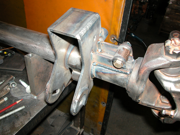

There could be one possibility of keeping it at about 6".............................
By using the above Ford radius arms you could eliminate most of the "high" items that require more lift for clearance.

Would the Ford arms replace the lower arms and eliminate the upper arms? Am I seeing that wrong, I am going to go find a picture of a ford front end.
Yes they do.

Those ( Yotas/LRs) would require a lot of work while the Fords would not, use a full width Ford with the stock Ford Radius arms, sure some fabrication but......
something to think about :wink:

PostPosted: Wed Aug 05, 2009 5:15 pm
Well....could start looking at EBs,( early Broncos) forget the exact width right now on them, they had about the same setup
but to be honest full width is the only way I would do one :wink:
only costs a nickel more to go first class :lol:
