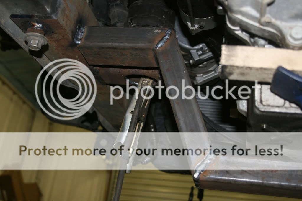

I am building a new cradle for the engine support and steering box. I thought about cutting into the stock cradle but figured I would loose some structure strength, I think the CRD has some twisty torque that I need to be prepared for. I was curious if you cut your cradle or fabbed a new one?

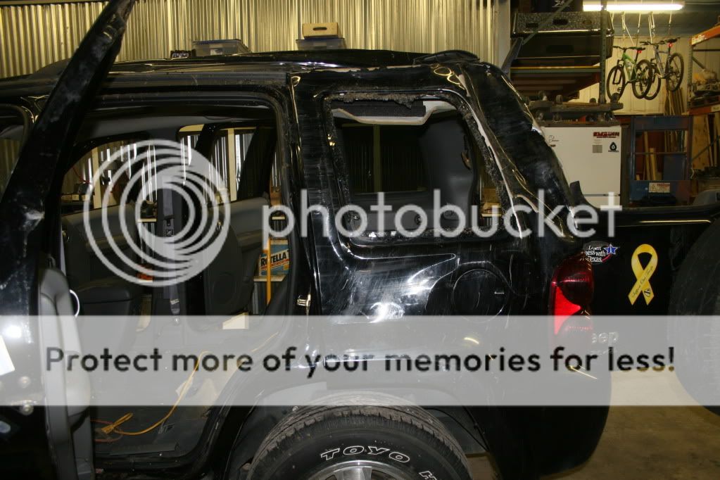

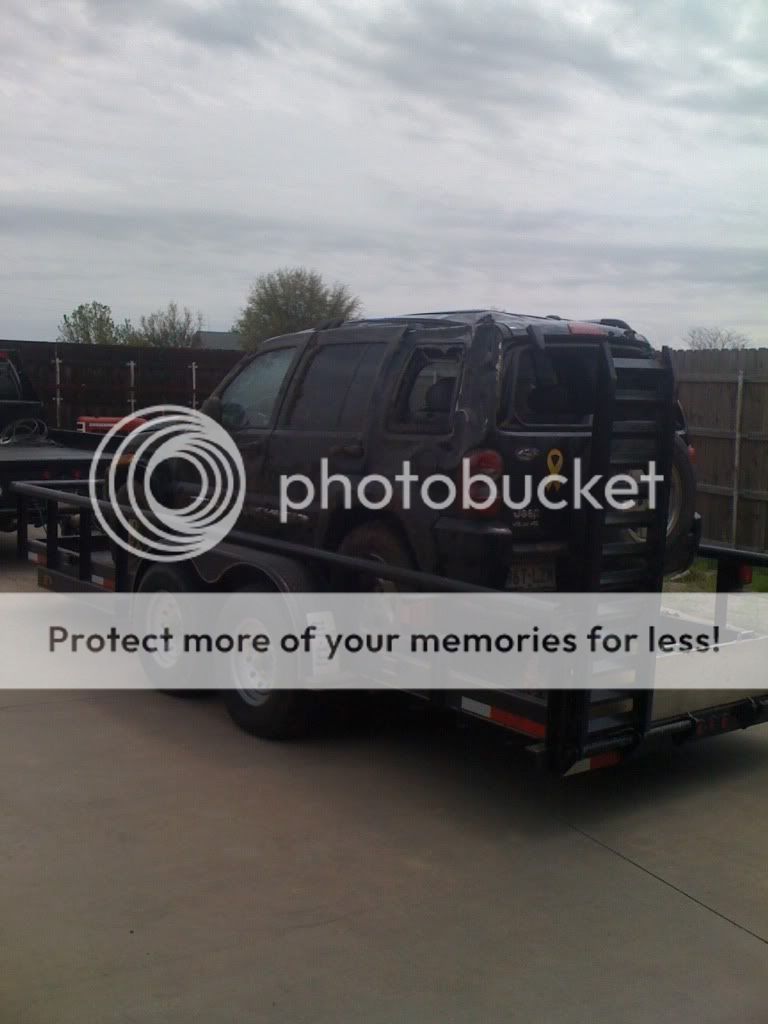

This is what started the whole project.
We did our own recovery, I didn't want it to end up at a body shop.
Disassembly Process.
Hammering the cab back.
I dropped the front axle and all components. Now I'm ready for fabrication.

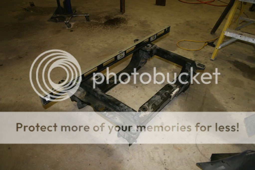

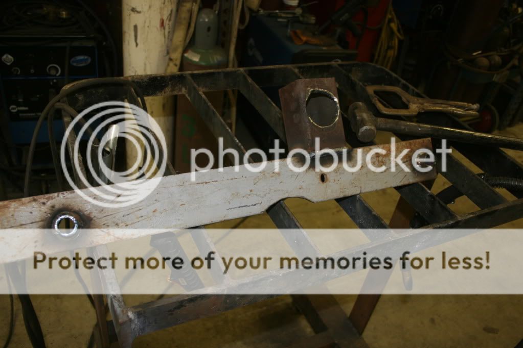

I did a little work on the engine cradle.
The rack and pinion is a dd shaft instead of spline, I can get a borgesson set and solve that problem,,,,,,, I think......
