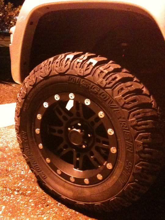

Well I finally ordered my rims and tires! I got the Pro Comp 7031's, 16x8 with 4.5" of backspacing and Cooper Discoverer STT's, load C. I had to get the 255/70/16 tires because Coopers web site said that the 245's shouldn't be run on an 8" rim. I'm hopping that they don't rub too much in the wheel wells. I'll do the pinch weld mod for sure.
Does anyone know if these will fit on the spare tire mount? If not what is a good one to go with?
Also, Should I get these Siped, siping before putting them on the truck? I can get it for free because they didn't ask me if I wanted it when I ordered the tires at Discount Tire and if they don't ask its free :lol:
Thanks!

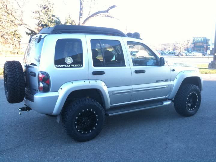

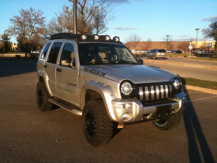

DirtyKK wrote:
darn you i was just sayin i want them rims! better post some pics!
Frankenlift 2.5" 3 ISO, 4.5 UCA, 16x8 Pro Comp Rims, 255/70/16 Cooper Discoverer STT, Pinch weld mod, Heater control mod, Custom graphics (made by me), Clear markers, Clear tail lights, Cold air intake, Flowmaster Super 44 exhaust, Blacked out grill with inserts, Removed Running boards, Removed all factory badges, Powertrax No-Slip locker
 Post subject: Re: Tires/wheels
PostPosted: Sat Nov 06, 2010 1:23 am
Joined: Mon Oct 11, 2010 6:19 am
Posts: 48
Location: Madison, WI
I love the new wheels! It totally sets it off!
PostPosted: Sat Nov 06, 2010 1:28 am
Posts: 2127
Location: Navarre FL
Sure do look nice! I think ill be ordering a set of 5 through 4wd hardware. They are having a sale on all pro comp alloys through November, found the thread on another forum. Still undecided though. I might just end up spending the mod money elsewhere and paint my MOABs a gunmetal or charcoal color.
