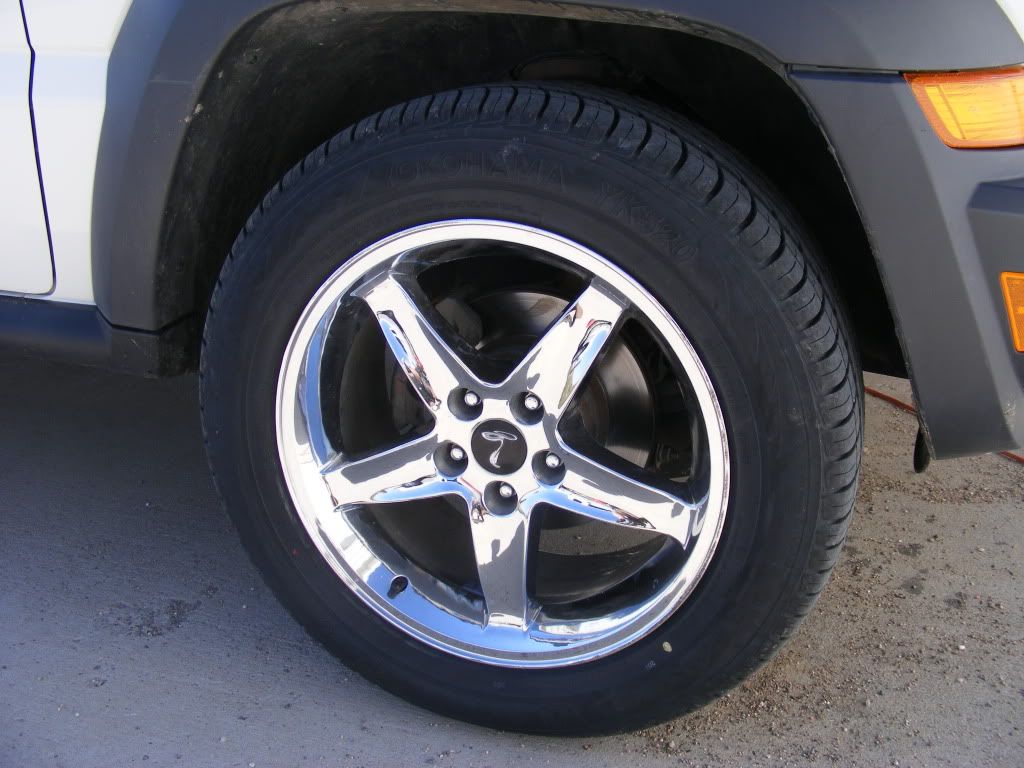

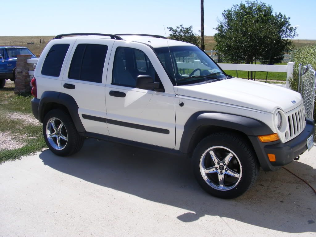

They fit!!!!! :BANANA: They are 03 Mustang Cobra R 18x9 wheels. Running 245/60/r18 tires (29.57" tall). I was running 245/70/r16 (29.5" tall). Ill get a pic of it up

I goofed up on the tire size earlier they are 255/55r18 (29.1" tall and a little over 10" wide) I'm sure these 255/55r18 will rub in extreme flex. But if I offroad ever I'll just put the stock wheel/tire combo back on. They just touch where the body seem sticks out when I turn. No worse than the stock wheels and other tires did.
Still haven't stole the camera from my wife to get a pic. I'm building a R/T version street/strip CRD Jeep. Kinda basing my build off the Grand Cherokee SRT8.
