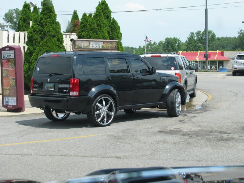

There will be some bulging, nature of radial tires,
not like the old bias ply or the little rubber rings they throw on 24s :wink: like this
I mean here are mine at the correct pressure and they are wearing flat across at 34 lb
