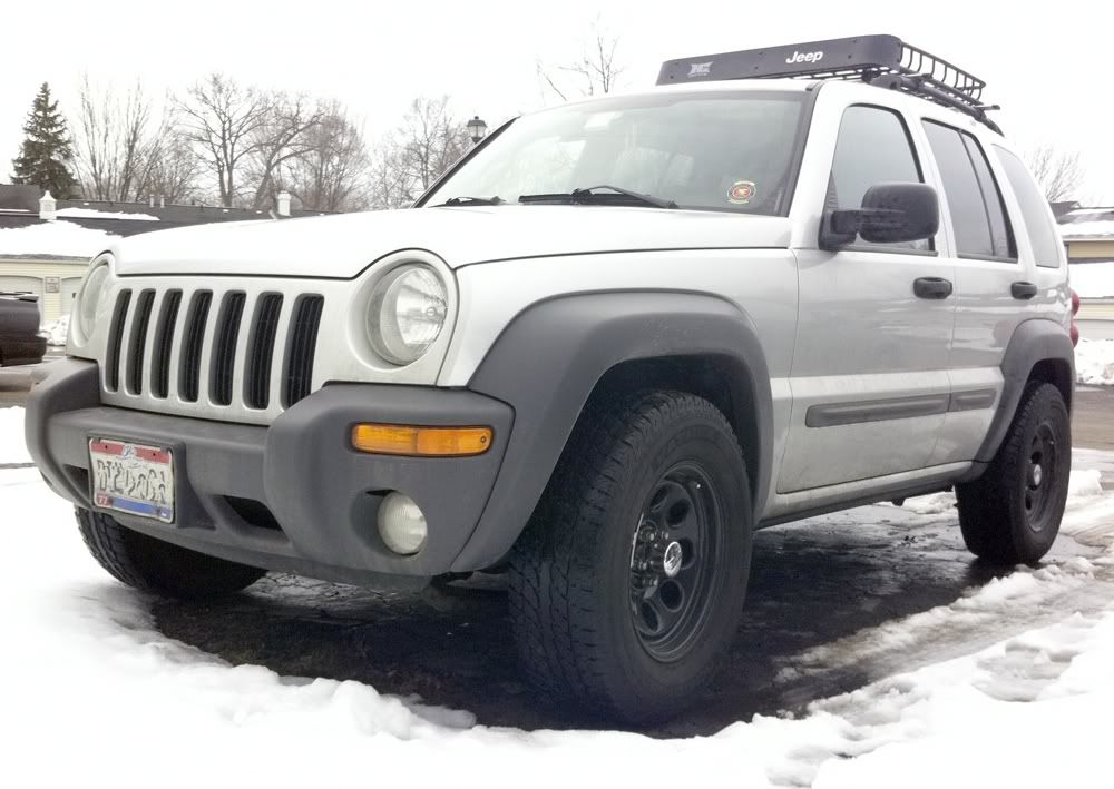

stock height....well not really LOL. seen here with about 1.5" of sag with soft 8's. 245/70/16. slightest ever rub on plastic of pinch weld at full turn due to the backspace of the softies.
here it is with stock wheels and maybe 1" of sag. No rub whatsoever.
here it is with Mudd's lift and gaining 4" of lift over the sag...3 inches of lift over stock
at the end of this summer prior to bad weather I'm going to Duratrac 245/75/16s...that's the stuff!!! :BANANA: :JEEPIN:
