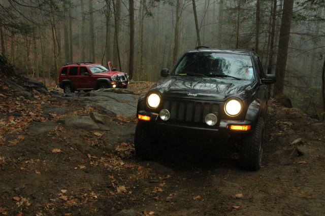

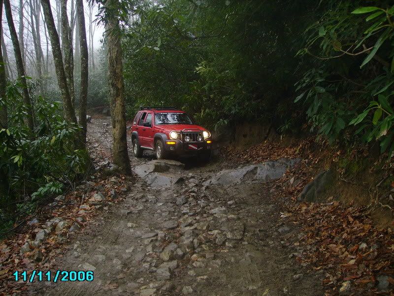

245 x 70 x 16 is the best size
you will not have to do anything to the Libberty and will look just as good.
and go just about anywhere we do. red lib was stock and did great.
Image Image Image Image
