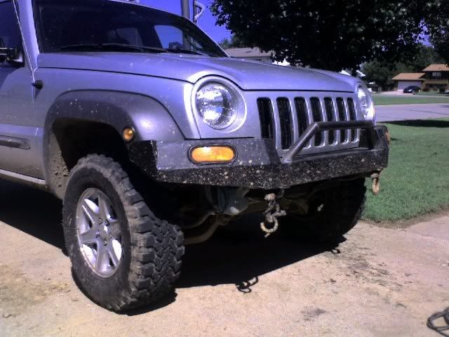

So if I were to get either the Cragar Soft 8's or the Cragar V-5, both steel wheels, would the 31" tire with the 15" wheel fit fine? I've heard that you will have to modifty the brakes unless you use steel wheels. If so, should I be okay in all ways with that size tire? Minor trimming and pinch weld pounding is anticipated.
And to anyone who has ever had the Treadwrights, someone told me you have to have them balanced more than usual? I'm going to go with the retreads no matter what, I'm just curious if I will also need to keep an eye out on their condition a lot. Thanks.

Oh and also, with the 15" wheel, would I need a 8" or 7" width? I know the bolt pattern is 5 x 4.5.

I'm running stock alloys with 245/75/16 Treadwright MT-Gs with the Pure-Grip. I will never own anything else. The tires are fantastic...if you go 15s get the 7" you will get a better bead when airing down. Just make sure you have the right back space... I know you get a little more side wall, but IMHO price of wheels (16" treadwrights aren't much more than 15") and brake cooling it makes sense to stick with recommended 16" wheel.
