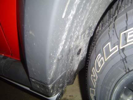

Well after an eon of staring at them in my garage, I finally put my blizzaks on. There was a lot of interference with the left pinch weld and the rubbed (read: smashed into) the front of the front wheel wells. I pounded the pinches (ugly but did the job) and trimmed off the air dam in the wheel well region. I've still got a pretty hefty interference in front on both sides. My steering wheel turns about 1.75 rotations before it is at lock, and I can only turn it about 1.25 rotations before I'm in the wheel well.
What is the best way to gain 3/4" clearance in the front without hacking it completely apart? I really don't like how cut plastic parts look if you can see them front the exterior. Don't mind it too much in the wells.
Here are the pics of how they look.

Boiler wrote:
I'm running soft 8's that come with 4" backspacing. So I think they stick out 1.5" more than the stock ones I took off.

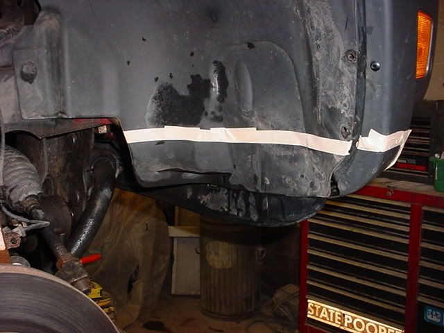

I'm running 255-70-16's with soft 8's and had to cut the crap out of my fender well to get them to stop rubbing most of the time. I still get some at full lock.
You might consider making or buying a metal bumper.

Heat the plastic up and bend out of the way, or cut off whatever is in the road. Thats what most do. Any action you take on a vehicle there is a reaction. For example, Sean150 still has rubbing somewhat at times due to not cutting the bumper of fully.
Plus should of let us go another ring , would of helped a smidgeon! :D
Or like 501 stated get a metal bumper, Rock Lizard has a nice looking one out :wink: :wink:
265-75s on mine with 8 inch wide wheels and 5 inches of back spacing and not a problem

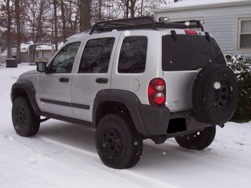

265/75/16's with 1.25in spacers..(same as 4in BS with the soft 8's) and after doing this i had no rubbing at all.
i'm sure you know this.. but finish the edges of your trimmed plastic with some sand paper and it'll look factory.
but then i eventually just went with this because i think it looks a lot better

Chip, are those 245/75's??? I can't believe those are rubbing! :?
and why do you have one round light on the roof rack? :lol:

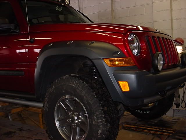

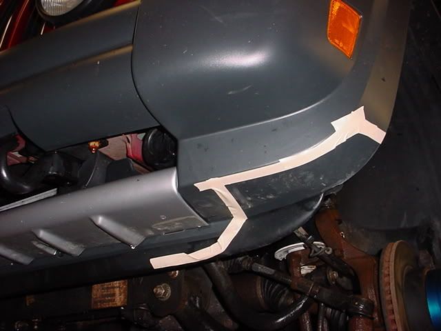

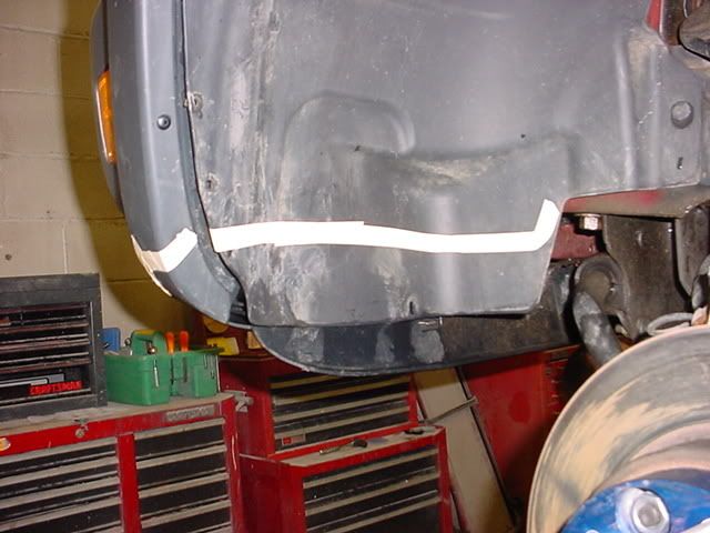

Chip, Towstrap has a 05 Renagade, we cut the bottem of the front bumper !! His turned out GREAT !! He gained ground clearnce and tire clearance and look's better. there is a pic. in the OHIO section under TOWSTRAP's NEW MOD !!
Item 1: yeah, I'm thinking maybe next week I should toss 3 conduit nuts in there, and THEN see what I need to trim. I'll need to trim some regardless, it hits a LOT.
Item 2: This is a joke right?
2006 KJ: I'll probably have to do half of the cutting you did.
I've been leery of cutting the bottom of my bumper off because I'm concerned the bumper will be loose / flapping in the breeze. For some reason I was thinking I'd seen someone with one cut off and it was pretty floppy. Will I lose much structurally if I cut the bottom?
I was kind of hoping to not tear up my bumper too much before I build one of my own, guess I won't have a choice. I can't design and build a nice one before I get sick of only turning half way....

...and why do you have one round light on the roof rack? :lol:
Looks like a snowflake on the lens to me. Just happens to be perfectly aligned with the overhead lights when the shot was taken. Same on the rear shot.

it wont be flapping in the wind. it is a little bit less secured but you would never notice it unless you physically go up to it and grab it with both hands and jump up and down on it. or you could just put 2 screws in it and it would be just as secure.
