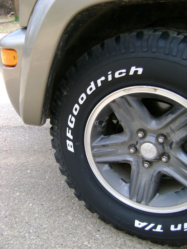

I've got the 245/70/16's on my 03 Renny unlifted. Looks good, barely rubs at pinch (pounded it down anyways) and at the fog light door.
Pics for person asking:
Front fender
WVU

looks good, decision made!...thanks for posting the pic!

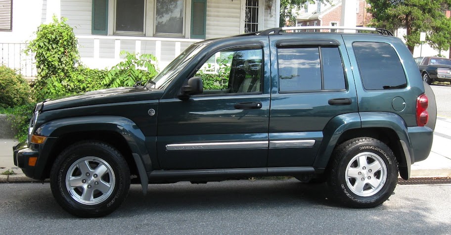

A little late, no lift:
With 1.5" lift:
NEVER an issue with rubbing, even with one wheel off the ground.

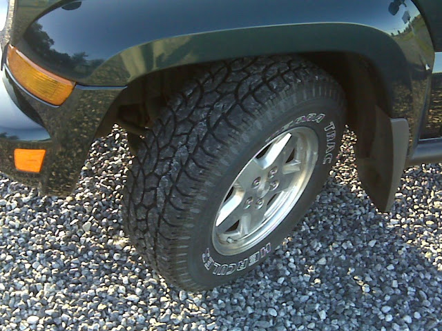

Mine are not BFG but still 245/70R16. No rubbbing and I hope if they still have tread when I lift they will still look good. these have been great tires. They handle wet and snow well, been off road and did well there too. THey seem to be wearing good and seem quiet on the road.
This is on the 235/70R16 that was on it when I got it.
With the new tires
