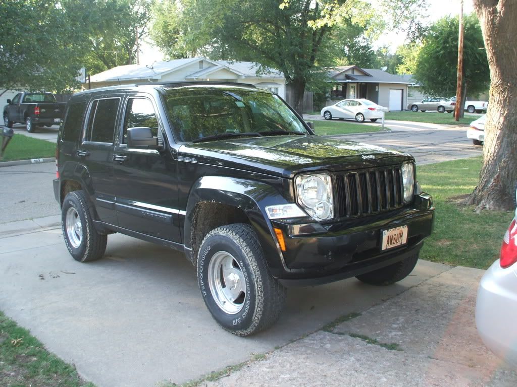

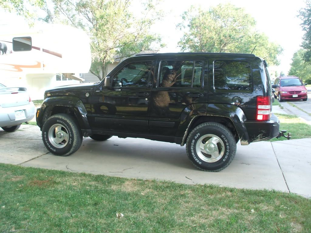

i'm putting this size on (265/70) in two weeks, going with Firestone Destination A/T's with a quote of about 180.00 a piece, mounted, balanced and with a road hazard!

got 'em here's the pix:

At $180 each, you're paying about $160 for the tire itself. I can buy the Generals or Firestones either one all day long online for $100-$110 per tire. Even with shipping, then taking them to get mounted and balanced I'm still looking at $30 per tire less than what you guys are being quoted. That's $120 on a set, and $120 buys some nice stuff for a KJ. :) BUT... I realize that some folks just like shopping locally even if it costs a lot more.
BTW.. the 265s look real nice. Thanks for the pix everybody.

yeah i wanted to go local for service reasons, the breakdown was $138 for the tire, plus $15 for the M & B, $19 for the road hazard then tax... close to $750 but i'm REAL pleased with them.
