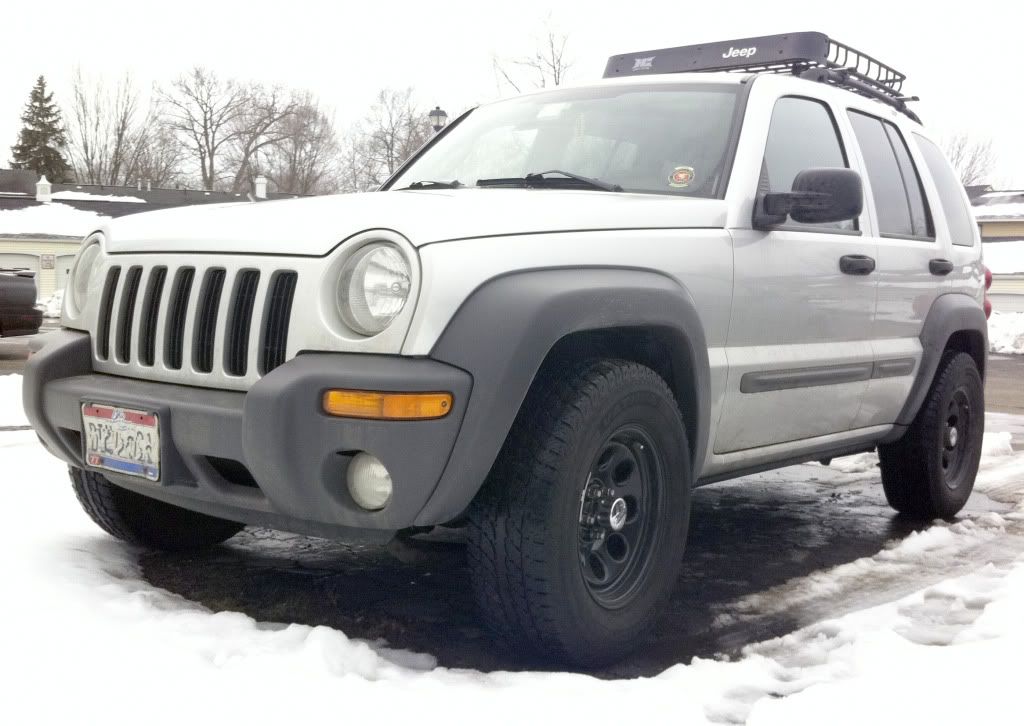

here's my 2003 with no lift with same size tires. barely a hint of rub on the pinch plastic. No trimming or pounding needed. I would recommend the 16x7 Cragars strongly with the 4" of backspace.
