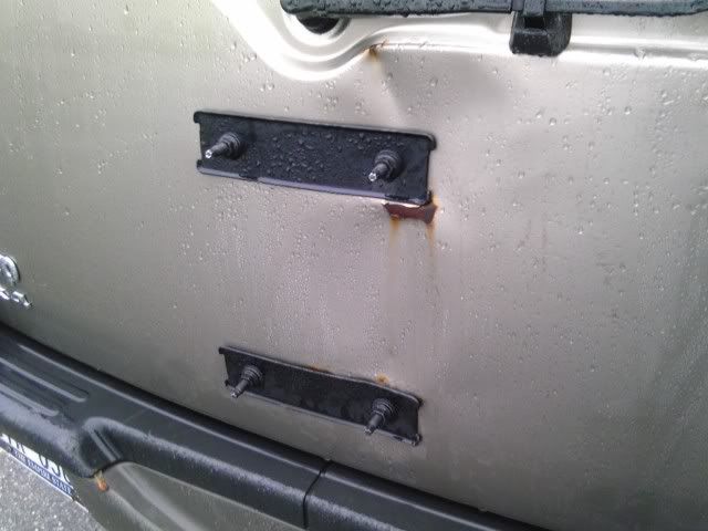

These four bolts are holding on the tire carrier.
They are e-torx bits.
I just used a 1/4 socket, gently to get them out.
EDIT:
That is to take out the studs completely, just take off the four nuts on the studs and the bracket will come right out.
-dbk

 Post subject: Re: will a....
PostPosted: Tue May 03, 2011 4:38 pm
Posts: 552
Location: Long Island
so do i flip thoes two plates and thats it?
PostPosted: Tue May 03, 2011 5:20 pm
You flip the bracket over is all it fits either way
PostPosted: Tue May 03, 2011 6:12 pm
Posts: 1778
Location: Queens, New York
Flip the piece that is missing in the picture.
Leave everything as is that is pictured, lol.
I'm making it more confusing, aren't I, lol.
