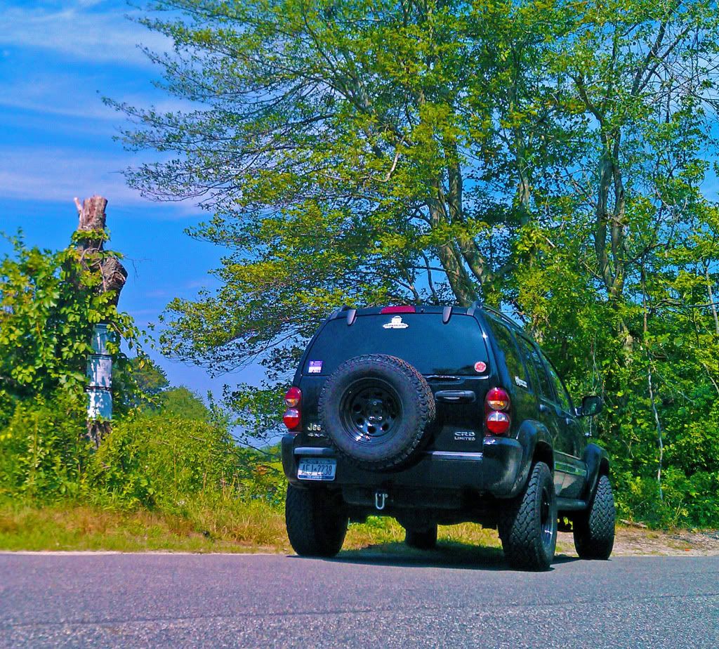

just got procomp rockcrawlers(soft8 style) with 4.25 backspacing. They stick out a bit further then my stock rims with 1.25 inch spacers did and im concerned about the rubbing in the rear under full flex. What is the limit with trimming the fender there? I mean the underside to allow the wheel to pass by, without rubbing and ripping off the fenders. I can grab pictures if need be.
Old rims with spacers
New rims

If your new rims are 7" wide like OEM rims then they stick out the same amount as OEM rims with 1.25" spacers given the new rims have 4.25" of back spacing.Now if there 8" wide rims good luck.

yeah they are 8 inches wide. They only stick out maybe ~half an inch more then they did before, and they rubbed lightly before without trimming, so i figure with trimming or adding longer bumpstops ill be fine. the staggered look is just too sexy to get rid of.
