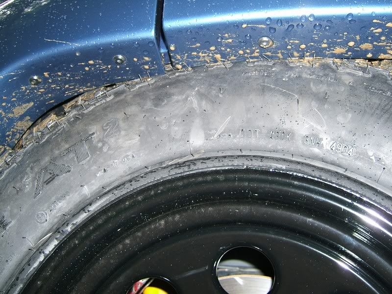

It will hit the fender. This is my 30x10 generals and rims with 5" BS before my extended bumpstop.

Have you measured your actual backspacing? My wheels are 3.750" bs and rub about the same as yours........something ain't right.

How do you measure BS mutt? From the mounting point to the outside of the rim or inside? Remember, I have the 255's but that still shouldnt account for why Im rubbing with 5" BS and you have 3.75 BS. I looked at my invoice and it says 5" BS.

3.75" bs would put the tires tread in that photo out even with the outside of the flare insted of inside the flare.
I put my 15x8's with 3.75" bs from my XJ on our KJ and the tires stuck out of the flare about 2" sitting flat. That was with my old 30x9.5's. I don't see how any 8" wheel with 3.75" bs would work on the KJ with anything taller than maybe a 28"-29" tire, and they would still rub.
I had the tire shop put on some 16x8's with 4.5" bs and my 245/75R16's, and they rubbed in front sitting flat, and just hit the flares in back when we jacked up one corner (to flex it).
