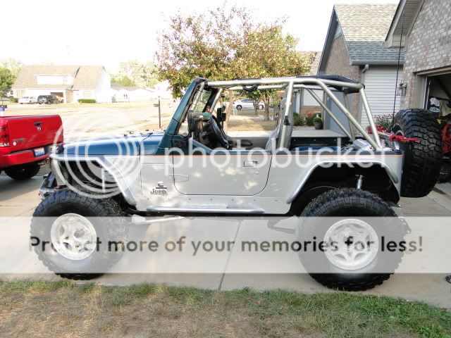

Anything is possible. Personally, I'd shy away from the Cherokees just because of the unibody, but to each his own. I just completed a similar swap using a Cummins B3.3T into a Wrangler. Like warp said, it's just a matter of taking measurements on the clutch / converter stackup and getting both the engine and trans bolt patterns to fit between each other.
Do it!
