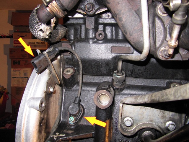

Hi,
my 2008 Voyager won't start, it has a P0366 code.
It has a 2.8 CRD (VM motori VM64C) engine.
The camshaft sensor has been changed with no success.
Do you happen to know where is the crankshaft sensor?
Thanks for your help.

CPS is located on right side of engine below exhaust manifold as shown in picture 1.
There is a heat shield that must be removed to gain access to the electrical connector and the sensor as shown in picture 2.
Picture 1.
Picture 2.

Thank you WWDiesel.
It is different on my engine, but I finally found it.
It is under the member supporting the engine mount.
