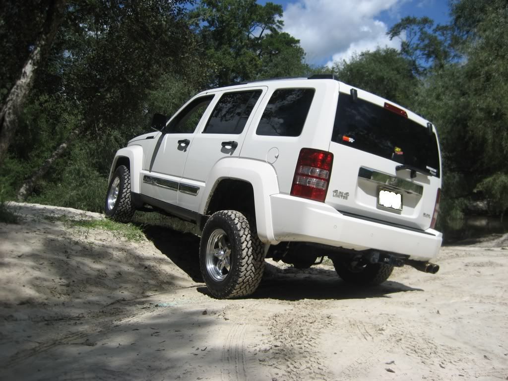

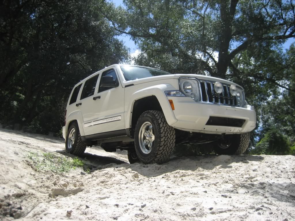

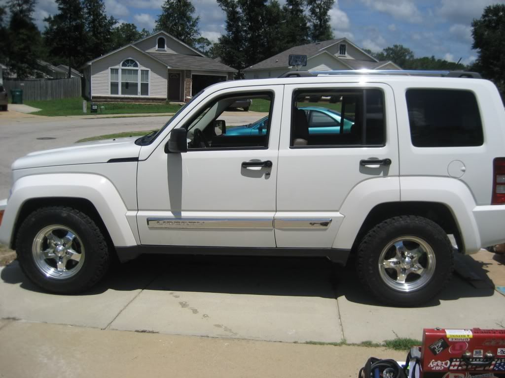

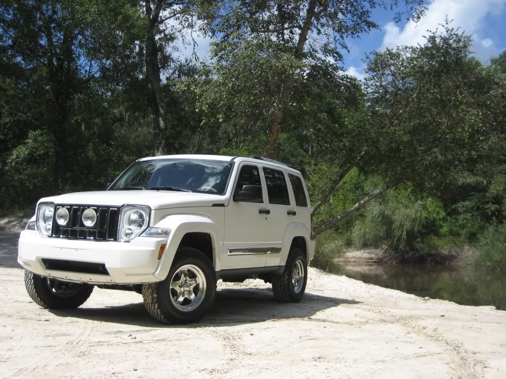

OK, the install went pretty good. The instructions from RK were good. The rear was easy and only took about 30 min per side. It's pretty straight forward.
NOW the front, that was a little more in-depth. If you get this I highly recommend 2 people for the front. I had a buddy with me and it made it a lot easier. The instructions for the front were ok, had to make some minor changes while trucking along but nothing major. The RK instructions get you to were you need to go. Over all the install went well.
Here are some before and after pics, as you can see in the after pics it started to rain so I didn't get to take a lot of after shots. I'll post up more pics soon.
BEFORE
AFTER

Here are a few more pics ...
