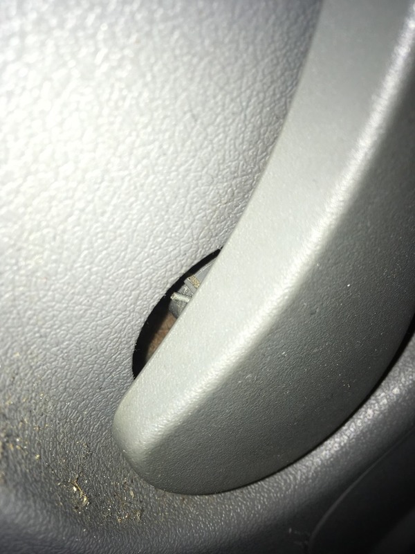

I went out there and tried pulling it apart hoping it would be easy but then I got nervous I was going to break plastic pieces so I stopped... How do I remove to get the plastic side piece and take lever off? Any tricks?

On the lever, look closely for a little metal spring. Push it down out of the slot with a little screwdriver and you should be able to pull the lever off.
The plastic sides are held in by the same metal trim clips that hold on the rest of the interior plastic panels.
