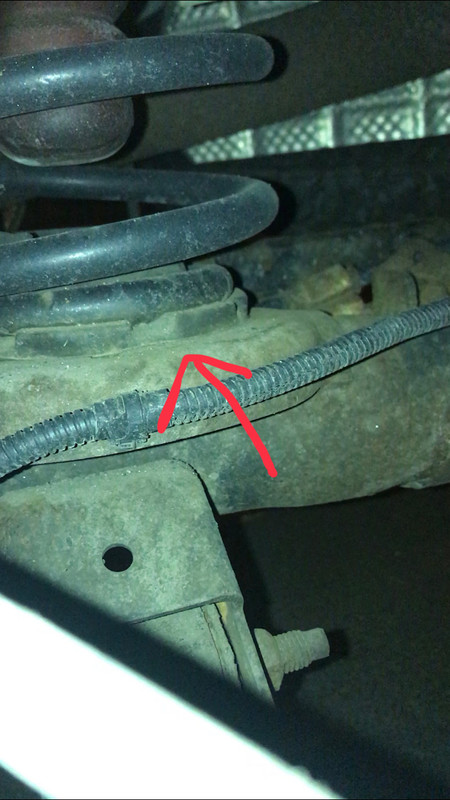

Alright so I crawled under to take some pics and see if there were any labels... I think I got lucky
Does this sound accurate?
Mopar Part No.: 52125554AA
52125554AA 1 J, T, U 74 [SDA+ZCW,ZRW]
Replaced By 52125554AB
My drivers side rear
Mopar Part No.: 52125553AA
52125553AA 1 J, T, U 74 [SDA+ZCV,ZRV]
Replaced By 52125553AB
My passenger side rear
 Post subject: Re: Rear Coil Springs
PostPosted: Wed Feb 20, 2019 3:19 am
Posts: 1503
Location: S.W Washington
Can't argue with an OEM tag. :D
Check the rubber spring isolators also, top and bottom of each spring. if they are deteriorating, replace those also while you have it apart. If you want the rear a tad higher, stack 1 extra isolator on top of each spring(3 per spring, 2-top & 1-bottom). You'll gain the thickness of the isolator, less compression of the rubber.
Alternately you could just ad the isolators now, adding that height. Then wait for the spring to sag more before replacing them. In your Pics, it doesn't look like the springs are totally stacked (compacted to the point of one coil loop hitting the loop next to it. ) yet.

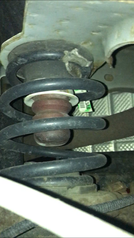

PostPosted: Wed Feb 20, 2019 9:54 pm
Joined: Wed Jan 02, 2019 6:59 pm
Posts: 29
Thanks for the advice and help
I tried to get a good pic of the isolators, what do you think, time to replace?
PostPosted: Thu Feb 21, 2019 12:31 am
Iso's look ok from what I can see
My question is why are you looking for stock springs
Much better ride and handling with aftermarket up graded springs
PostPosted: Thu Feb 21, 2019 1:11 am
Posts: 29
can you give me some direction? I was mainly looking for springs because I want to keep stock ride height, I am not looking for a lift.
PostPosted: Thu Feb 21, 2019 1:08 pm
Posts: 1503
I agree with Tom, the isolators seem to be oK from what I can see in the Pics.
