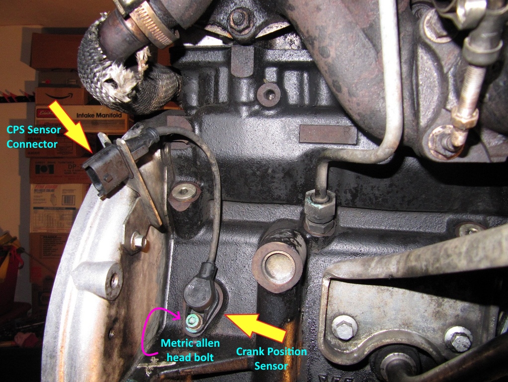

Very Common Issue!
P0336 -- Crankshaft position (CKP) sensor – range/performance problem Insecure sensor/rotor, air gap, wiring, CKP sensor
Replace the Crankshaft Position Sensor, they commonly fail on these vehicles with age. And when they fail, they commonally never set a DTC, you are lucky that it set one to tell you what your issue is.
Replace it from underneath vehicle while jacked up or on a lift. Not a real bad job, takes about 30-45 minutes.
CPS (crankshaft position sensor) - 5066882AA
Duralast Crankshaft Position Sensor PN: SU8492 (OEM Bosch Part in AutoZone Box)
CPS is behind this heat shield:
Close up view of CPS location:
