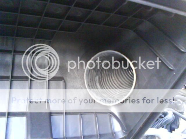

I still have the stock air box in place, so basically that is what I am trying to do.
Right now I have a 3" tube running inside the air box hole and am using an inner-tube as a gasket.
This is an old Pic, since then I have trimmed the tube flush with the lid.
With the K&N filter and RAM air hole in the air box, I have very little air flow restriction.
The problem is that the 3" tube is not large enough to stretch over the new TB. It is also not really strong enough to use a coupler on only the outside of it without reinforcement on the inside. The hose clamp would cause the hose to collapse. So right now I have a coupler on the inside of the 3" tube so I can clamp the outside. The coupler reduces about 1/2 of the new TB opening gained. Kinda defeats the purpose.
The new TB OD is just under 3-1/8" the air box hole is just under 3-1/2" OD.
So if I can find a stiffer 3-1/8" hose I can clamp it directly on the TB and use a 3-1/2" coupler on the air box side to join the two.
I have looked into a OEM 4.7 intake tube, but the shapes just aren't right for what I need.

Stock air box outlet OD is 3-3/8" New TB OD is 3-1/8"
I have given up on finding an intake tube that is 3-1/8" ID.
Spent more hours then I like trying to find something. I even looked at the 4.7L cold air intakes, but they all use 3"- pipes. Go figure!
So once again it is DIY time.
I just ordered some things to make my own intake tube.
First was some pipe insulation with an OD of 3-1/8", it should be here on Wed.
I will then use the pipe insulation as a mold to make my own fiberglass intake tube. The tube will be connected on each end with rubber gaskets and pipe clamps.
Wish me luck, and check back here for updates.

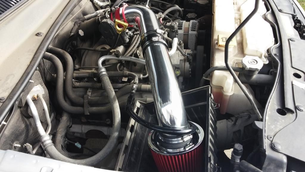

Thought I would share where Im at with this. I too am currently on the "local" salvage yard hunt (a lot cheaper if you can pick it yourself off the junk vehicle), but I did get my intake installed so I am ready for the TB. Here is what Im working with...

^^^^^^^ I like how you used some of the original air box. I might need to try that.

Scar0 wrote:
I have scoured the internet looking for something that is 3.125" ID to no avail. :banghead:
@ Dewphy What is the ID of the pipe you are using, brand, and cost(if you don't mind me asking)?
No worries, it was just an intake kit off ebay from the seller Trackracing for $55. I believe the tubes have a 3" ID. I chose it since it wasnt that stupid dual filter design and from the pictures it looked like the filter would sit right where the stock air box was and it did. I have to note that originally it didnt fit since the coupling that went from the tube to TB was 3" to ~3.5" for some reason (gonna give the seller a call). So i just ran to autozone and grabbed a 3" to 3" coupling and thats what you see in the pics.
I have thought about modifying the tubes (cut them shorter ect.) so they route to the stock air box and just couple the outlet of the box to the inlet of the tube assembly. Unless i see problems from the elements making it to the air filter and until I get a TB, I wont worry too much about this.

Now comes the issue of the air tube.
My DIY CIA uses a 3" smooth bore RV sewer pipe for the connection to the TB. But 3" ID needs to go to a 3.125" OD TB.
I was hoping to be able to heat up the sewer pipe and stretch it over the new TB... But it did not work. So tomorrow I will need to get a new intake tube to go from the air box to the TB. For now I used the same coupler I was using on my OEM TB which makes the inside diam 2.75"(approx). Kinda defeats the purpose of the new TB, but at least I can drive it.
The other thing I thought of, that was not previously mentioned, was the intake manifold opening. What good does a larger TB do if the intake hole is the same size as the original TB? To my surprise the intake manifold opening is actually larger then the original TB opening, and just a hair smaller then the new one.
Now I have the little bugger installed and hoping the rig will run.
WOW fired right up on the first try! YEA!
I was warned by Gageraid the RPMs seem to hang a little longer, which they did. Each time I reved the engine the RPMs would hang there, rev a little more and the RPMs go up again and stay there... I'm thinking DANG IT! It's not going to work!!!
Finally at 4000 RPM it broke, and dropped to a 1000 RPM idle. A few more revs and it dropped to a 700 RPM idle with very little hanging at the top RPM. I think the rig was just getting a feel for it. Anyway, it is acting almost like normal again. Tomorrow comes the road test.
After I get a new air tube, I will post back with more Pics.
