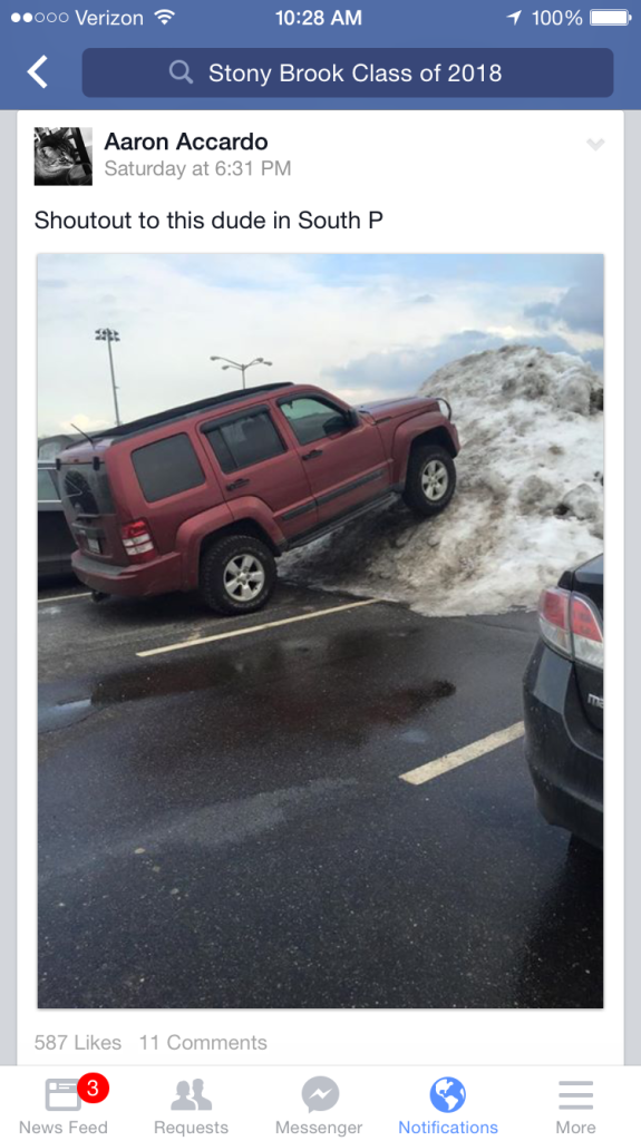

I'm getting internet famous at my school. Almost 600 likes lol

haha, that's great! wish I had piles like that here in PA...

Always laugh when I see people pull up on snow like that
Buddy did that at work, had to finish up after quitting time and came out with everyone gone.
Well it seems there was a warm up somewhat during the day, must of been a hole under the snow when it was piled up
There his sat, front wheels dangling, frame of the CJ sitting on the snow, rear sitting on ice ( where snow melted and ran down ) no one around, even locked front and rear couldn't move :ROTFL:
I drove over 40 miles to pull his dumb a** 5 foot , he never lived it down :lol: :lol:
PostPosted: Mon Feb 16, 2015 4:01 pm
I was only like that for an hour or 2 and it was solid ice. My tires barely left an imprint. I can see if your doing it all day(especially with sun beating on it). But if it's an hour or 2, or night time below freezing temps you're generally safe.

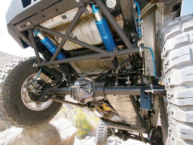

I did some measuring and planning...(Bmx would like this) for the cantilever rear suspension. It'll be close to $2000 to do a full conversion in just parts alone (going really top of the line). Have to cut the spring perch and reinforce/make new axle shock mount for the push rod. Push arm would be tubing with Johnny joints, but heim joints would work too. The pivot would be on the unibody shock mount with a simple 90* degree triangle to allow the axle to pivot the rod/pivot triangle in the right direction. Here's the biggest hurdle (outside of the giant price tag)...relocating both the EVAP canister and exhaust/resonator. These two fill a void where some 8"-12" travel ORI STX struts would go to do the hard labor (like I said reeeeaaalllyyyy top of the line haha). The EVAP canister can be moved just off to the side of the hole for fuel lines is in the spare tire wheel well. Do a resonator delete and just have the exhaust piping bent to allow it to leave just behind the passenger tire a good ways. The exhaust bracket also needs to be moved and putting it on the other side of the unibody rail should give it enough support the lightweight metal. Of course...all brackets will have to be custom built...The pivot triangle would be two pieces of 1/4" sheet with 1/4" sidewall tubing as the spacer/bracer. The unibody strut mount will be a 1/4" fork bolted to inside of the rear bumper. Sounds like a lot, but once the brackets are made it's an easy bolt-on haha.
PostPosted: Tue Feb 17, 2015 2:05 pm
Exhaust is easy. Cut the resonator off and do a turndown before the rear axle, or like you said route it out the side.
Evap would have to be moved to someplace similar to jeepmonkey's, assuming that it doesn't interfere with anything.
The cost seems to mostly be due to the coilovers themselves. You might be able to save some money going Bilstein or Fox instead of King or ORI(like you said, top of the line).
Obviously you'll have to ditch the spare(who uses that anyways? :jester: ), or atleast relocate it(inside, roof, rear tire carrier).
I think the hardest part would be getting the math right on everything and then picking the right spring rates and valving.
Edit: I think doing something like the Offroad Evolution JKU setup would be easy. You might be able to bolt it to the "chassis" like where the hitch bolts to. Then you can add a skid to it for extra protection.

PostPosted: Tue Feb 17, 2015 2:28 pm
This is the offroaf evolution setup on a JKU. Seems very easy to do. Can't see why we can't, I'm pretty sure we have more overhang than a JKU

Just need to custom fabricate all the metalworks haha.
PostPosted: Tue Feb 17, 2015 2:45 pm
Figuring out how to size the pivot triangle seems to be hardest. You could probably even do normal poly bushings if you want to try and keep noise down.
PostPosted: Tue Feb 17, 2015 3:27 pm
Posts: 1054
Should be easy with a starting template and just moving the push rod to actuate everything and simulate everything. My guess is that when sitting flat the unibody mount hole to strut mount hole should be parallel. This will allow the strut to be at close to compressed and it will extend when the axle goes either up or down.
