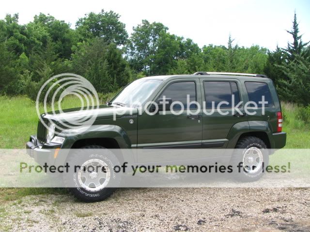

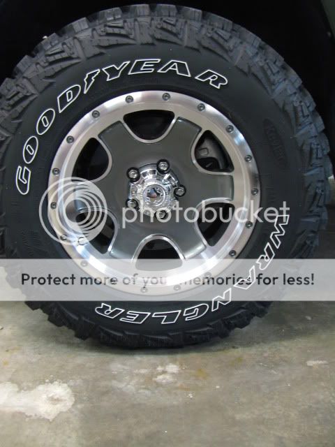

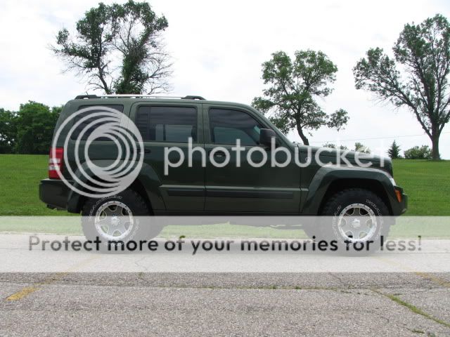

Now that I've installed aftermarket wheels and larger/off-road tires, here's a little comparison:
Before JBA 2.5" Lift Kit Install:
After JBA 2.5" Lift Kit Install (still with OEM wheels/tires):
After JBA 2.5" Lift Kit Install and with 245/75R16 MT/Rs on aftermarket wheels:

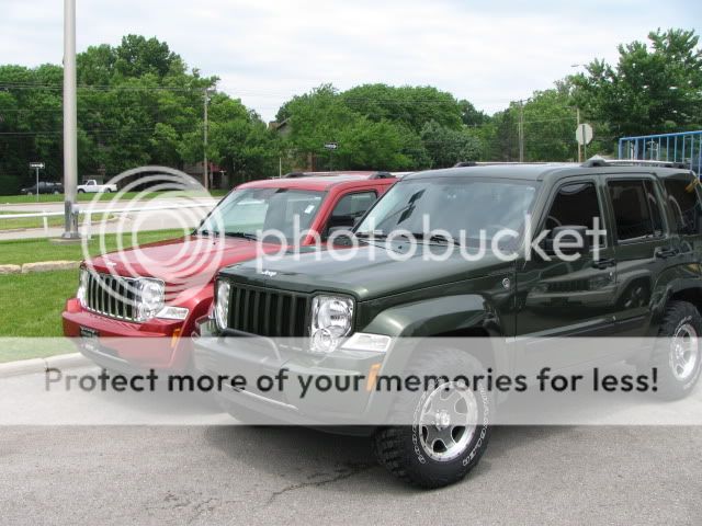

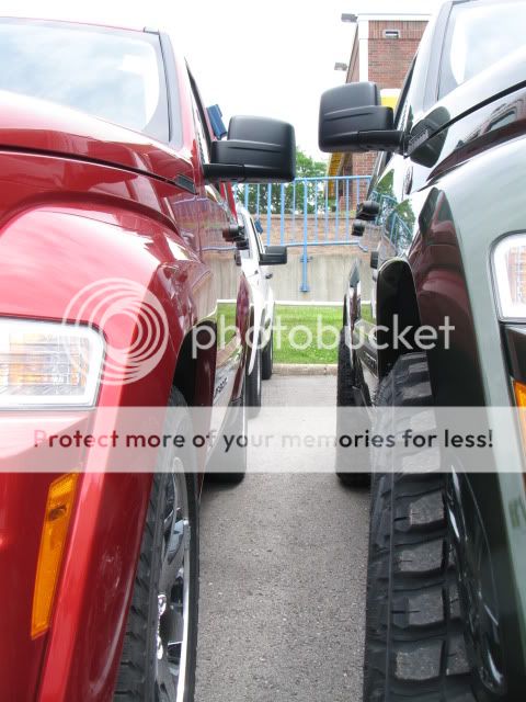

And now a couple side by side shots with a stock KK:
I'm beginnnig to get my KK configured the way I've been envisioning. I hope this info helps anyone considering mod'ing their KK. I'm going to post more detailed info on my wheel research / selection and tire fitment in the KK Aftermarket Wheel & Tire Survey thread.

Looking good :D
PostPosted: Sun Jun 14, 2009 2:11 pm
Posts: 327
Location: South Western Pa
8) sweeeeeet 8)
08 KK Jeep Green
PostPosted: Sun Jun 14, 2009 3:07 pm
those new tires and rims look super sharp expescially the rims! the rims LOOK like suped up Jeep rims and go perfect!
PostPosted: Sun Jun 14, 2009 3:33 pm
awesome looking KK.. really like those tires/wheels.
if it were me i'd be trimming that front bumper :)

Thanks ya'll for the positive and encouraging feedback.
2006 KJ, I've since removed the black lower air dam. As for trimming the bumper itself, won't be happening anytime soon.....if only someone made a winch-compatible bumper for the KK.......
JeepinJarhead03, yeah, I really like the wheel looks too -- that's why I was willing to go with a little light wheel well rubbing versus getting a wheel with greater backspacing and have no rubbing at all.

PostPosted: Sun Jun 14, 2009 9:11 pm
well depending on where it rubs, you may be able to use a heat gun and soften the plastic fender liner and use the head of a hammer to push the plastic in a bit, there's a bit of dead space behind the fender liner in many locations - several of which both kj's and kk's tend to rub a lil bit with the larger tires or different rims
let them rub for a week or two and jack'er up and get a good eyeball or two on the rub marks - could turn out to be something you wouldn't have to trim, simply a heat and push a bit dealy

hello, very nice KK
about your rims, it's 16x8 but with any offset ? -40 ? -20? 0?

Need 5 inch backspacing on an 8 inch wheel ( when lifted )
then better yet is a 7 inch wide wheel with 4 inches of backspacing ( again lifted)
7 inch gives you more choices as far as tire size. With an 8 inch wide wheel you need to run 255-70-16s or 265-70-16 ( of course again only if lifted )
