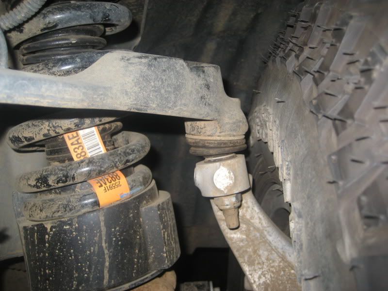

Diggerfreek wrote:
In the mean time, will some one with a spacer lift and OEM arms and some one with JBA arms please post a picture of the upper ball joint with out the KK being on a jack.......please :P
Daystar 2" and OEM arms picture coming up.

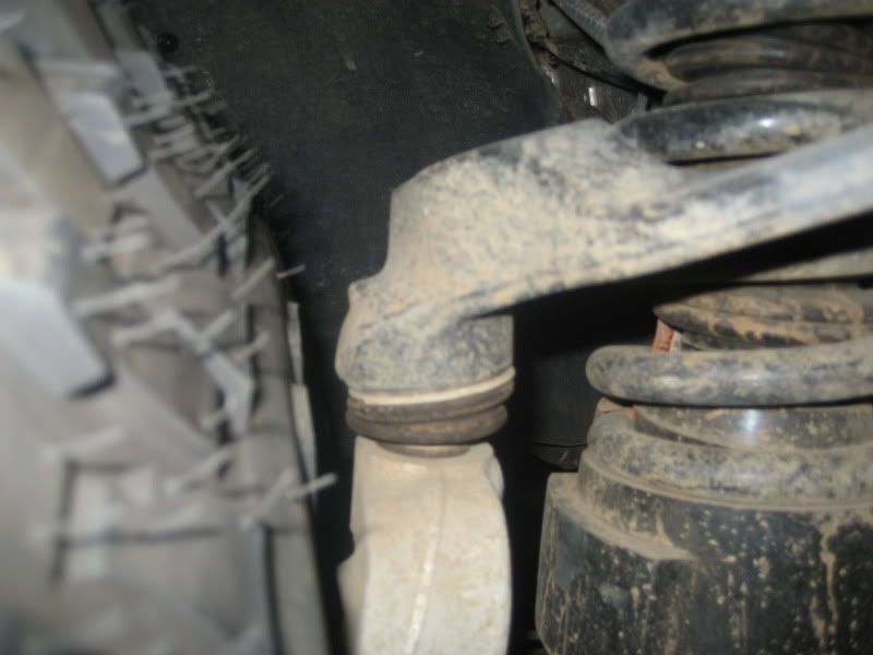

from the front looking to rear:
from the back looking to front:

hum.... the angle is pretty good
