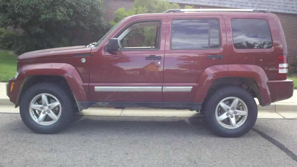

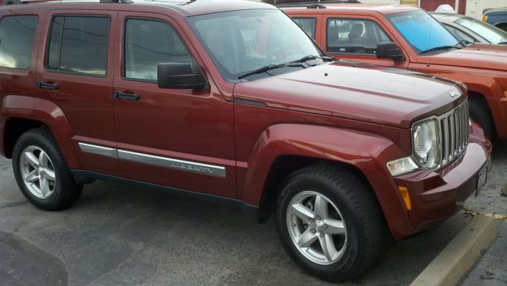

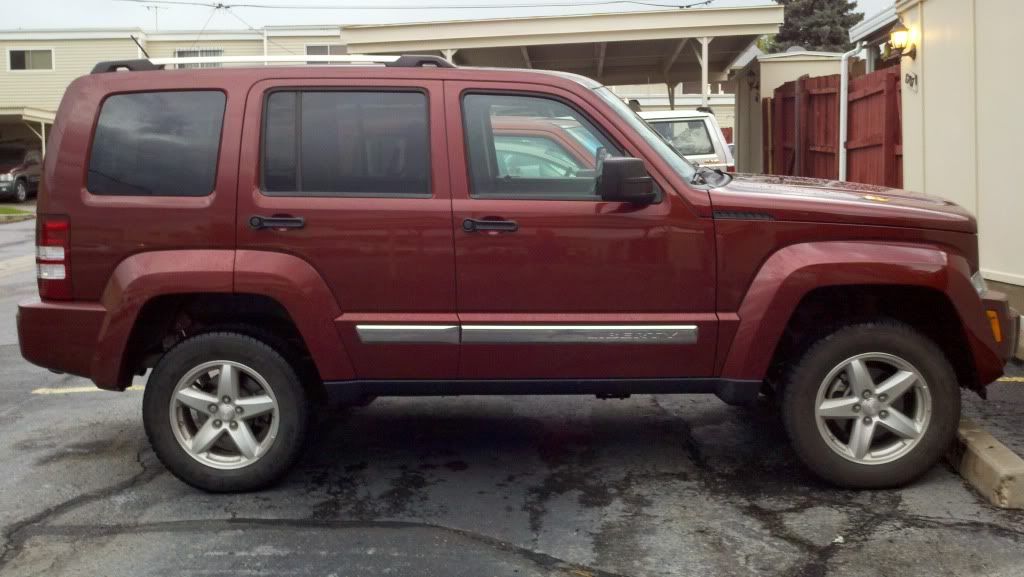

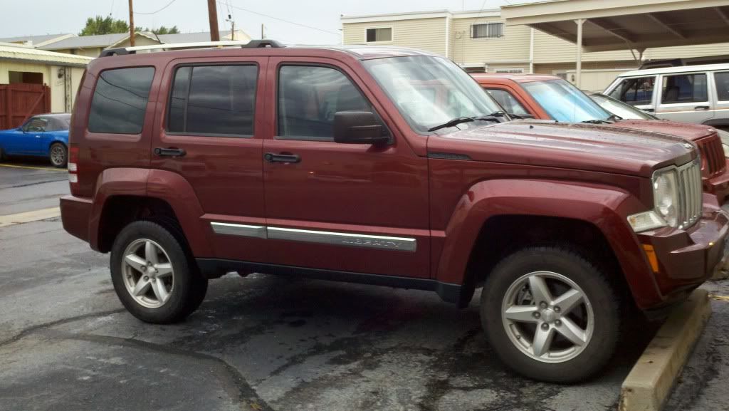

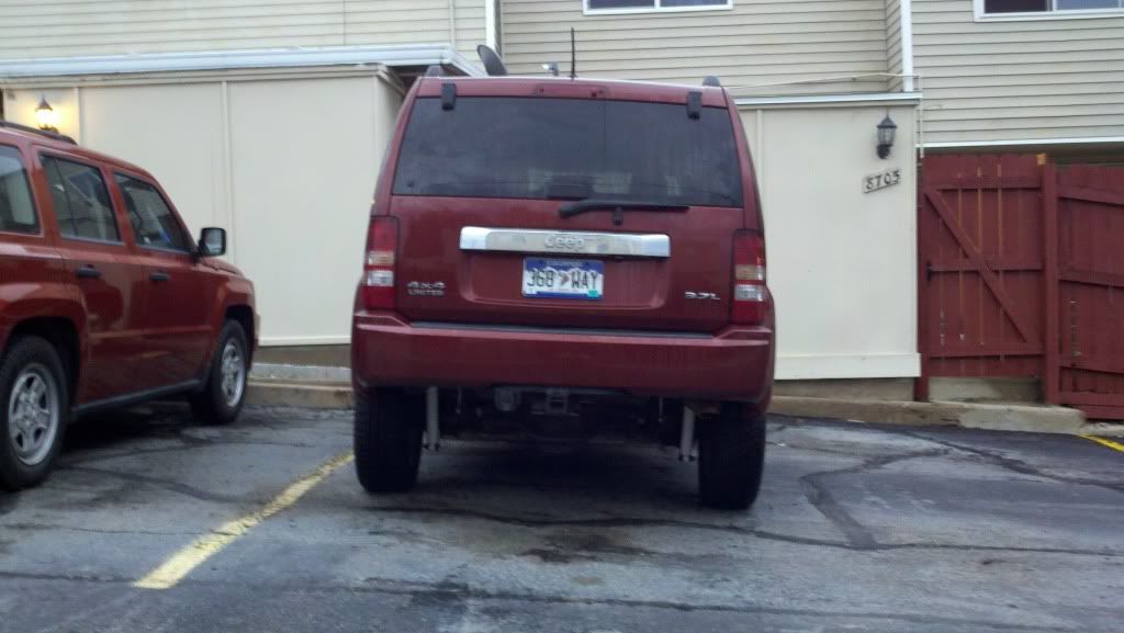

OK its official...I have pictures. Here is the story for all of you wanting to do this lift...*THE BILSTEINS DO NOT WORK WITH THE OME SPRINGS*...SO this is what is installed:
FRONT
OME 2927 Coils
OME NS131 Shocks
REAR
OME 2731 Coils
Skyjacker N8088 Shocks
The rear is a little bit bouncier than what I would have liked, but all in all the thing rides like a darn mercedes! Not only that but here are the measurements:
FRONT BEFORE: 18 1/4"
REAR BEFORE: 18 3/4"
FRONT AFTER: 20 3/4"
REAR AFTER 21"
Ok without further BSing..here are the before and after pics. Also, I am taking flat stanley out this week for a camping trip, so dont miss those pictures later on!
BEFORE
AFTER

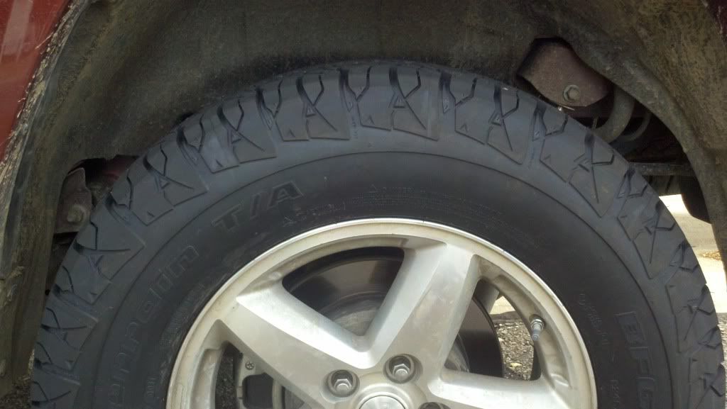

Got my new kicks on the other day :pepper: BFG Rugged Terrains! I'll get some pics up once I have the chance to take them up wheelin'

Looks great. What size did you go with?
Lost Jeeps PNW/BC Members Map
 Post subject: Re: Got it figured out!
PostPosted: Tue Jul 26, 2011 11:54 pm
Posts: 284
Location: Troy, OH
Looks like 245/70's/17 maybe? Maybe not?
