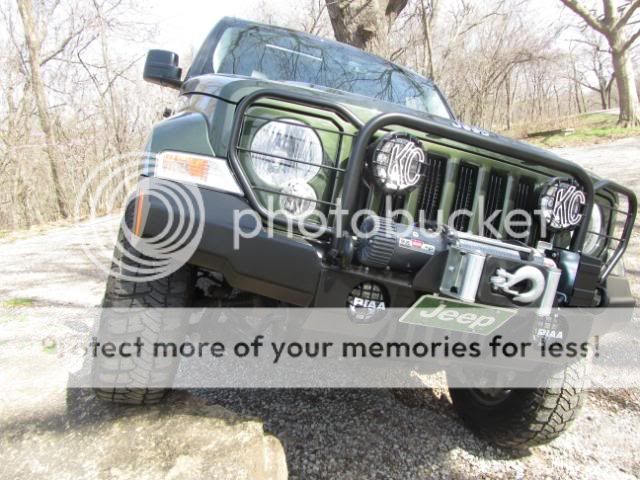

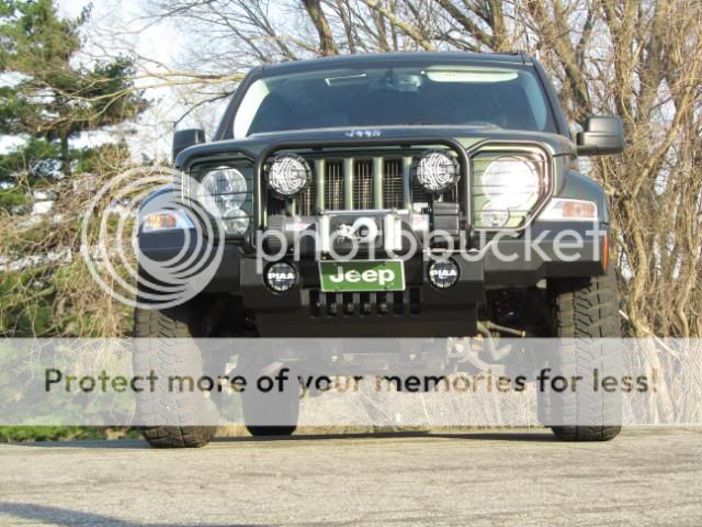

Thanks all for the feedback, public and private, on my KK Off-Road Bumpers and Rock Sliders. In total so far, it has been about 14 months to date in the making since I started preliminary design and component research since there haven't been any options for KK Off-Road Bumpers. It has been more than 9+ months without my KK (except for occassional weekend visits back to my house for design iteration and test-fitups) as it has been at the couple street rod shops I worked witih.
I certainly wouldn't have made it with what's left of my sanity without the patient support of my #1 helpler, my dad, who helped me install, test-fit, remove, refit, mock-up, etc. the many developmental iterations of the bumpers throughout the 9 months. He also was patient with my prolific photo and note taking during each of the iterative test installs during development. I also need to thank my best friend and extended family for on-going interest, encouragement and actual help installing the final painted bumpers. Also need to thank a couple LOST peeps (that know who they are) that helped me in various ways through being a sounding board and/or helping research some of the components I was trying to find along the way.
Thanks to all Image Image Image Image Image

 Post subject: Re: MtnLuvr's KK Off-Road Bumper Weight Info
PostPosted: Sun Apr 10, 2011 1:40 pm
Posts: 1013
Location: Kansas City Area
dieselenthusiast wrote:
Have you had the chance to total the weight for each bumper? I have a feeling that those bad boys are heavy.
You know me Rhett, I've tracked and accumulated all types of detailed and/or quantified information throughout this process. Thanks for asking, as its a good question that I'm sure multiple people are curious about. Obviously, no matter what, switching from OEM plastic to steel is gonna add weight :wink: , so here's the low-down....
MtnLuvr's Heavy Duty KK Off-Road Front Winch Bumper:
    114 lbs for Heavy Duty Off-Road Front Winch Bumper, including all tow hooks, brackets, fasteners and hardware
    - 36 lbs for OEM front bumper (less lower air dam strip removed long ago), including both OEM front tow hooks
    78 lbs approximate net weight change (bumper only)
Optional Heavy Duty Radiator and Power Steering Skid Plate another 28 lbs (versus OEM radiator skid at 10 lbs)
Optional Grille Guard from 11 lbs (Stinger-Style) to 15 lbs (for Full-Width Brush Guard style).
So, as seen on my KK with my radiator skid plate and brush guard, I net added about 115 lbs (including powder coating allowance of 4 lbs) to the front of my KK before installation of my winch. Winches can add another 65 to 90 lbs depending upon the winch size, manufacturer, synthetic or steel rope, etc.
MtnLuvr's Heavy Duty KK Off-Road Basic Rear Bumper:
    152 lbs for Heavy Duty Off-Road Basic Rear, including brackets, D-Ring shackle tabs, rear tow receiver, Jeep scuff plate, tow plug, fasteners and hardware
    - 14 lbs for OEM rear bumper assembly
    - 36 lbs for OEM bumper tow hitch assembly
    102 lbs approximate net weight change
So, I net added about 108 lbs (including powder coating allowance of 6 lbs) to the rear of my KK due to my Heavy Duty Off-Road Rear Bumper.
MtnLuvr's Heavy Duty KK Rock Rail Sliders:
So, I net added about 18 lbs to the middle of my KK due to my Heavy Duty Rock Rail Sliders.

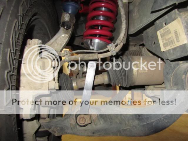

 Post subject: Re: MtnLuvr's JBA 4" Adjust-A-Strut Lift Info
PostPosted: Sun Apr 10, 2011 2:45 pm
Posts: 1013
Since I'm in posting mode, here's some stats on my KK's height after initial installation of JBA's 4" Adjust-A-Strut Lift Kit. All dimensions taken while parked in my garage on a flat, level surface even though photos taken elsewhere.
Keep in mind after suspension replacement lifts, there is typically some settling which occurs mostly over the first couple weeks to month or so.
Fronts from center of wheel upward to lower edge of front fender flare = ~21.5"
Rears from center of wheel upward to lower edge of rear fender flare = ~23.75" (starting with 2 isolators top and bottom to see how the back settles out), also installed an extra spring isolator on the driver's side since the driver's side of KKs are always lower than the passenger's side.
At this height setup, it yields approximately 12" clear below the bottom of the driver's side front of the OEM engine skid plate and more than 11-1/4" clear below the driver's side rear of the OEM engine skid plate (with my GY 245/75R16 MT/R tires).
As for front CV angles, the above front heights yield about 10 degrees with the vehicle parked flat (e.g. no IFS extension):

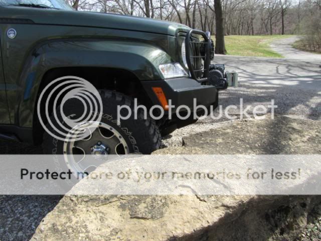

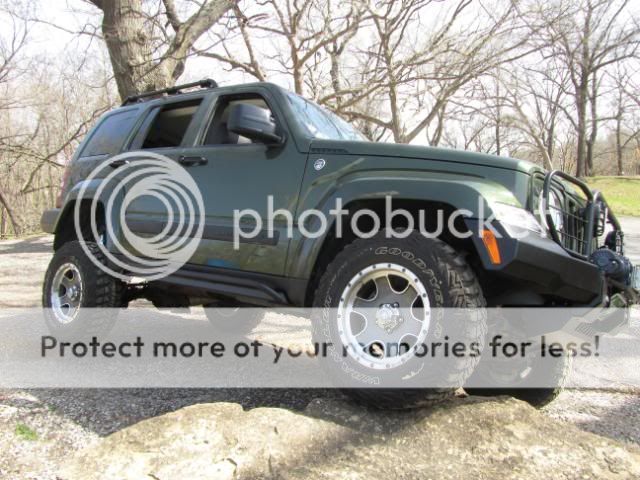

 Post subject: Re: Don't Try This with OEM Bumper (or Ride Height)....
PostPosted: Sun Apr 10, 2011 7:48 pm
Posts: 1013
Don't try this with the OEM bumper or at stock height....
Note, vertical rock face is well above wheel hub center.
2009 KK Limited 4x4
Coming: :twisted: :JEEPIN:
PostPosted: Mon Apr 11, 2011 4:39 pm
Posts: 2733
Location: Atlanta GA
This thread is like IFS liberty porn...
