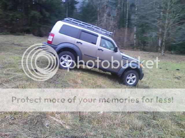

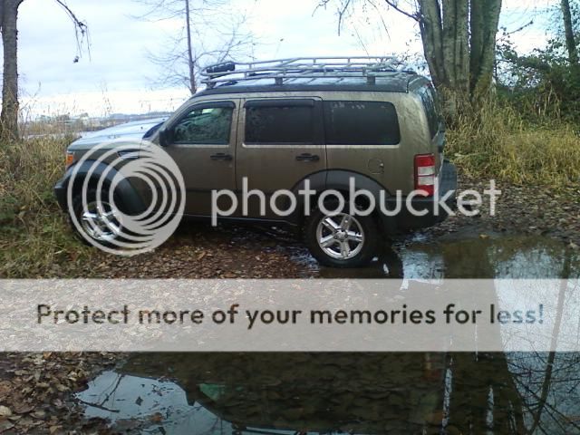

Little fun in the water.
And a Video...
http://www.youtube.com/watch?v=EUhDNVV5rAo

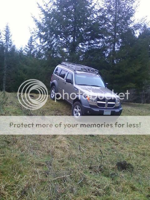

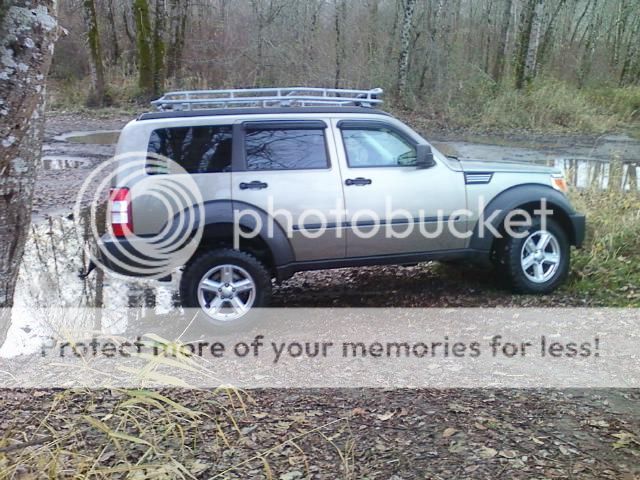

Did a little wheelin up at the mountain property, and tested the E-brake after I adjusted the right side. It holds like a champ now.

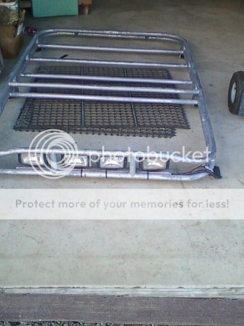

Well the rack is off. Not sure how the vinegar wash is going to work. After I finish stripping the old paint off, it does not look like much of the Galvi will be left.
Maybe I should just have it powder coated and be done with it... Thoughts?

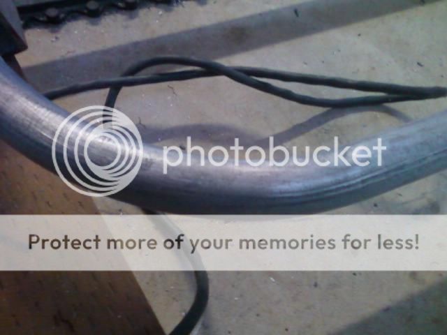

Couple of progress Pics.
This one is after 1 vinegar wash. You can see a little discoloration.

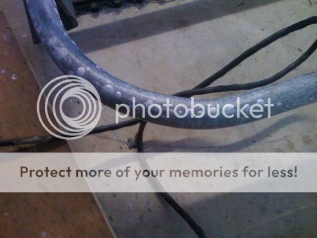

This is after 5. I think I went too far with 5 washes. You can see the zinc-oxide has clumped up into little drops where the vinegar created a drip. Once the vinegar evaporated it left behind the clumps.

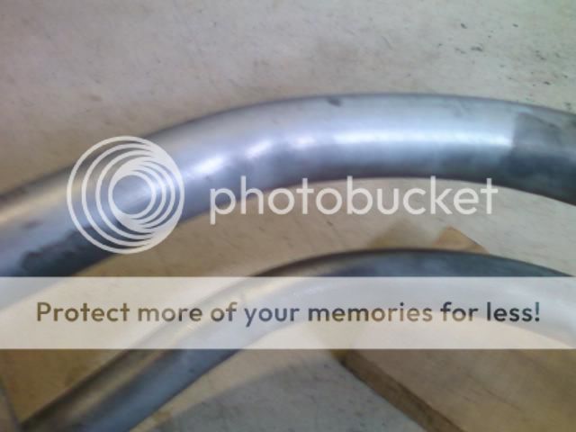

There is no way I was going to paint over these, so I sanded off all the clumps.
Now I am going to wash it with acetone to remove the vinegar residue, then hit it with the primer (which I still need to get).
