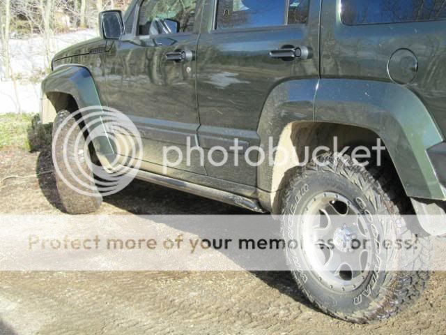

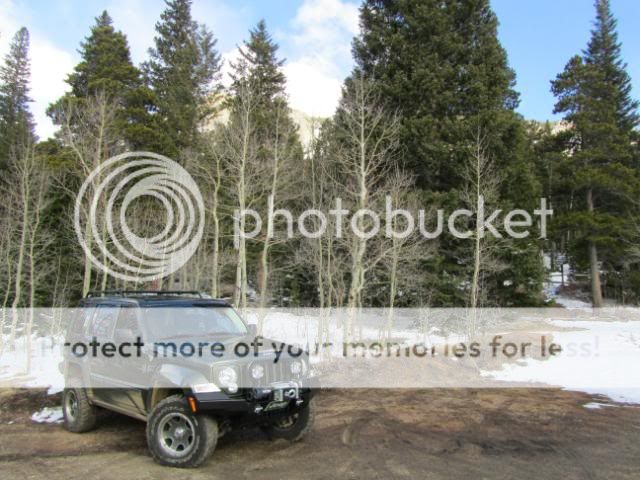

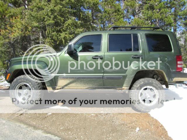

Ok, few quick photos of my Heavy Duty Rock Rail Sliders while in Colorado:
(the longest rock rails possible for the KK's rocker guard panels)
(you can see the mid-brace and how far out the slider rail tubing extends in this photo)
2009 KK Limited 4x4
Coming: :twisted: :JEEPIN:

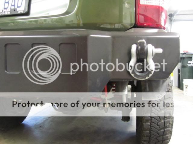

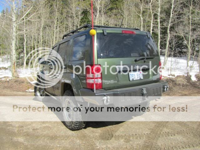

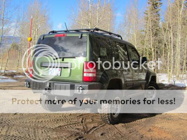

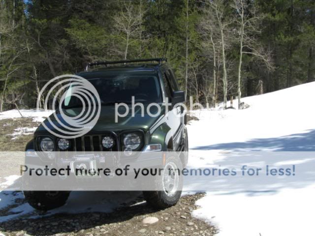

And here's some photos of my Heavy Duty Basic Off-Road KK Rear Bumper:
(liking the dramatic improvement in departure clearances, which is really rough on the KK versus other Jeeps)
(still before getting the exhaust resonator raised on the passenger side and before relocating the EVAP canister on the driver's side to gain even more clearance underneath just inside the critical wheel path)
The reason I made this mad-dash to Colorado was to clear out a storage unit I had in Fort Collins that contained a lot of my camping and backpacking gear. I need some of the camping gear for Pastafari Moab trip coming up. I tell you, as I was loading my KK up while cleaning out the storage unit, I sure was glad I designed my rear bumper with the recovery shackle tabs outboard as I did because not once did I hit my legs on them :D . The heavy duty round rod that taperes down and out from the tow hitch receiver serves multiple purposes, it acts as a skid plate for the receiver that hangs out, it is a connection point for safety chains when towing and by flaring outward and being rounded, they also keep you from knocking your legs into the receiver hitch when shifting sideways leaning into the KK. The scuff plate on top of the bumper worked out well too. I'm very pleased with the functionality of the rear bumper.
Tomorrow night I'll go back to the front and start posting photos of the various Grille Guard Protective Hoop options.... :CAMPING:

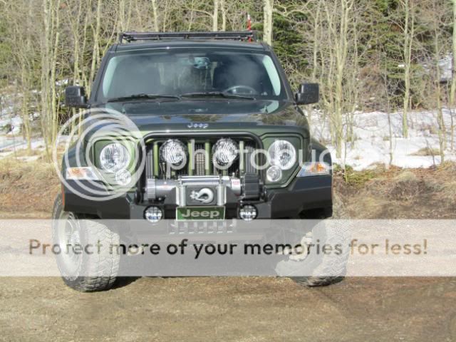

Ok, a few photos of the completed Basic Grille Guard Hoop:
So, in the 3 preceding photos, the 6" KC off-road lights are mounted to the included "inner" mounting tabs which are centered on dividers between grille slots.
Alternately, I designed the Basic Grille Guard Hoop to also accomodate 6" off-road lights (at included mounting tabs) at the inner top of the vertical sides which puts the lights toward the "corners" of the 1.50" diameter formed hoop as you can see below:
(having the 6" lights up toward the inside "corners" of the hoop maximizes radiator exposure as you can see)
(ready for action :JEEPIN: )

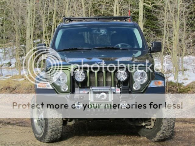

As you can see from most of the photos of my KK since getting my KK off-road bumpers painted and installed, I've been running the Full-Width Brush Guard Hoop as I personally like the looks it gives my KK. Since the Full-Width Brush Guard Hoop builds upon the Basic Grille Guard Hoop, it too has light mounting tabs so the lights can be mounted in either of two positions (centered over outer grille slot dividers or up toward the "corners").
(my KK missed the snow this winter in Kansas City since it was trapped in my street rodder shop while the prototype bumpers were being built)
(awesome yet fully armored approach clearances)
(my TanKK, equipped with Full-Width Brush Guard Hoop mounted to my KK Winch Bumper, is ready for some wheelin' :JEEPIN: )
