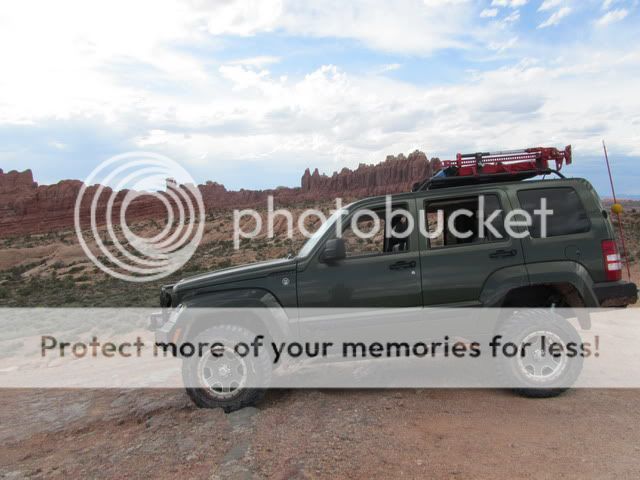

Started my week-long wheeling test-out of my KK Off-Road Armor in Moab Pre-LOST Pastafari 2011:
:shock: I was quite pleased the difference wheeling my KK today on Fins & Things, Klondike Bluffs and Tower Arch trails around Moab versus last spring. The additional approach and departure clearances afforded by my bumper designs made a HUGE difference. I know there were many instances today where the OEM bumpers would've made contact with a rock face or the ground yet today my KK Off-Road Bumpers didn't.
:BANANA: :BANANA: :BANANA:
Feeling like my hard work developing Off-Road Bumpers for the KK which create maximum approach and depature clearances, especially along the critical wheel path, is paying off. Later after getting some photos from kskj, I'll be able to show the benefits of these clearances in action.
The Heavy Duty Rock Rail Sliders held up great too. It was last year in Moab that I bent up the simple 2-cross-bar mounted RRO sliders I used to have (which then caused me to have to have some super-heavy duty mount sliders built to complete the full armoring of my KK). :JEEPIN:

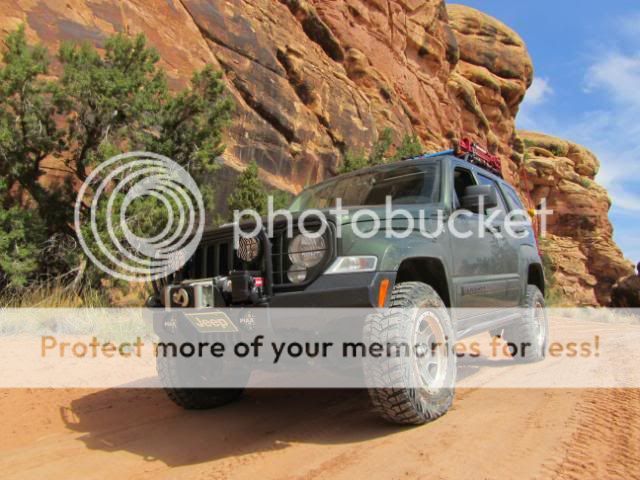

Another day wheeling in Moab Pre-Pastafari 2011 and proving out that the maximum high-clearance approach and departure angle designs of the Front Winch Bumper and Basic Rear Bumper make a dramatic improvement wheeling the KK. It is so nice to be wheeling in Moab again but without having my KK's bumpers contacting and getting beat to heck on various rocks and trail obstacles.
:JEEPIN:
After this week in Moab, I'll post some action and close-up photos taken by others on the trail crew while I was wheeling my fully armored TanKK.

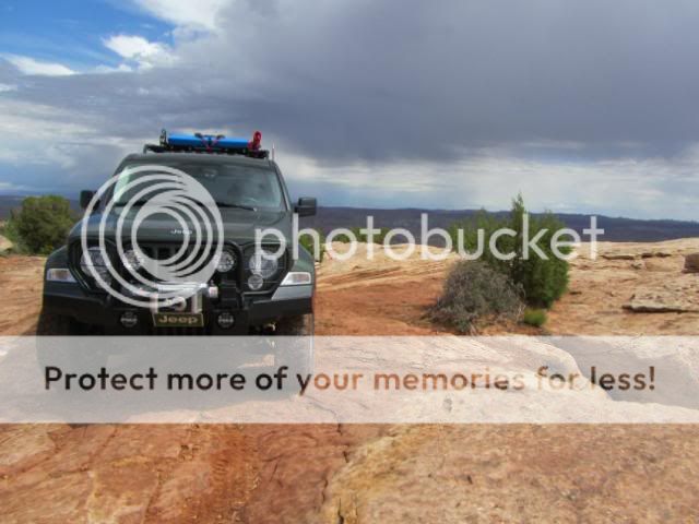

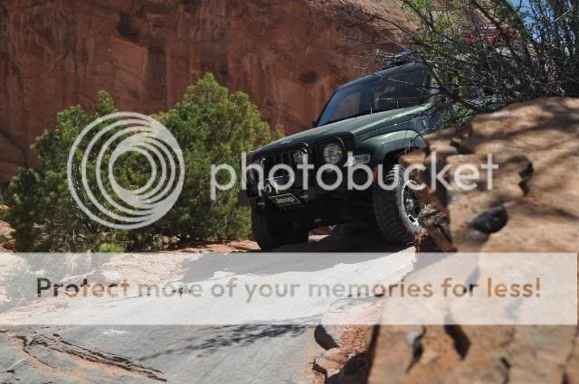

Ok, before I quickly post up some pics of the benefits of my improved approach and departure angle KK Off-Road Armor, here's some quick (mostly "poser") shots from my May trip out wheeling in Utah as part of Pastafari 2011:
I've always liked Moab in the spring....the desert isn't blazing hot and you get the beautiful contrasts of the desert with the snow-capped La Sal Mountains in the background. 8)
Of course, in the Moab area, unlike the midwest where I live, the rocks are so dry that you get amazing traction since it is like driving on sandpaper:
(I thought this was a pretty interesting shot, thanks Taylor :) , showing a unique perspective on my KK front-end armoring and KK-integrated Rock Rail Sliders)

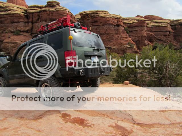

..and let's not forget the Heavy Duty Basic Rear Bumper on the long-tailed KK:
(beautiful scenery to explore and as photo backdrop)
and a little rear flexing....at one of our stops, I stopped with my driver's nose diving which created a little passenger rear flex from the JBA 4" A-a-S lift, plus it gives a different perspective on the fit, finish and integrated trim-out of my Heavy Duty Basic Rear Bumper. Although, I left the OEM rear wheel well lines uncut to see if they'd maybe act a little like mud flaps....not certain if they're helping much in that regard :lol: .

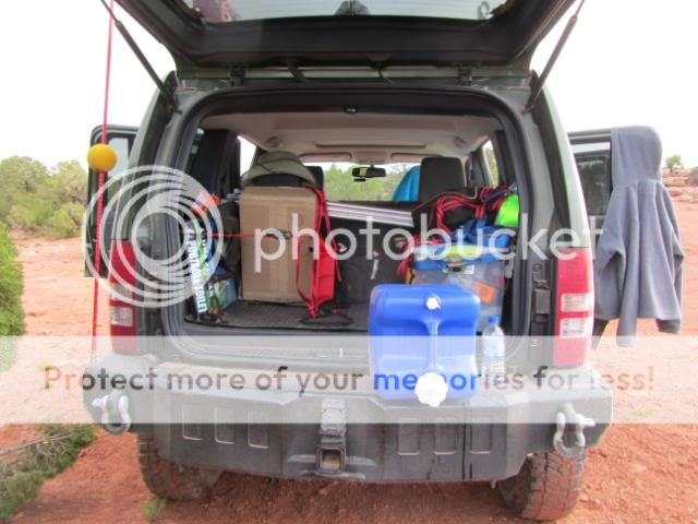

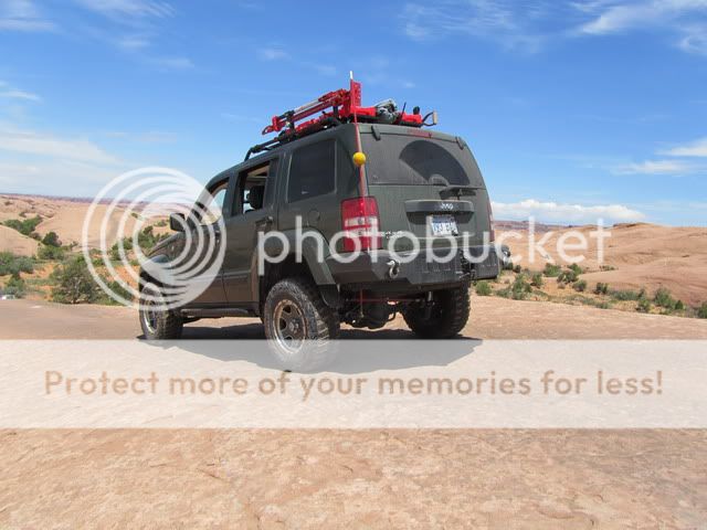

Speaking of the rear bumper, since the large group part of Pastafari 2011 was 4-days/3-nights backcountry, hauling all your own water, spare fuel, food, camping gear and usual off-road supplies, here's a shot of the back of my KK as used (and prior to packing up my campsite) at Panorama Point (Wed 05/25 evening and Thurs 05/26/2011 morning).
As you can see in the above photo, my high wheel-path clearance Heavy Duty Basic Rear Bumper design offers multiple advantages. Since with the KK we're stuck with OEM vehicle structure sticking out back so far for the under-tail spare area (and maybe for crash worthiness too), having the Jeep scuff plate integrated into the top of it, besides making the appearance look more integrated with the vehicle, also provides a good no-slip surface for stuff placed on top of the rear bumper. You can also see the CB antenna mount provision being used. Biggest feature I'd want point out in this photo is how with my placement of the rear recovery shackle tabs outboard of where most others have placed theirs, you don't have the rear shackles, or tabs, as points you're going to hit with your legs when you are loading or unloading gear or cargo from the back of the KK's (larger) cargo area. The chamfered and rounded edges of the bumper design also smooth things out so there aren't any sharp edges to cut you or bang into. With the receiver hitch assembly centered, and with its itegrated tapered skid bars/safety chain connection points, I have yet to run into the receiver with my body when accessing the KK's rear cargo area. The sealed tow plug connectors, which has connectors for both 7-pin and 4/5-pin, did a good job keeping water/mud and dust/dirt out of the connections.
After wheeling my TanKK around Utah for a week, I am super pleased with the performance of my mods, including my Heavy Duty Armor. Now on to a post about the benefits of improved wheel-path approach and depature clearances.....

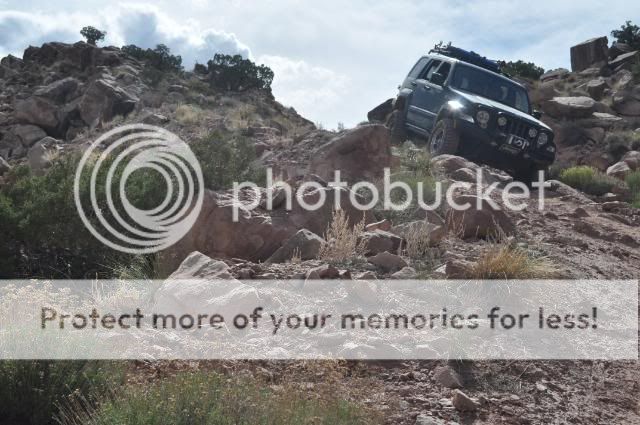

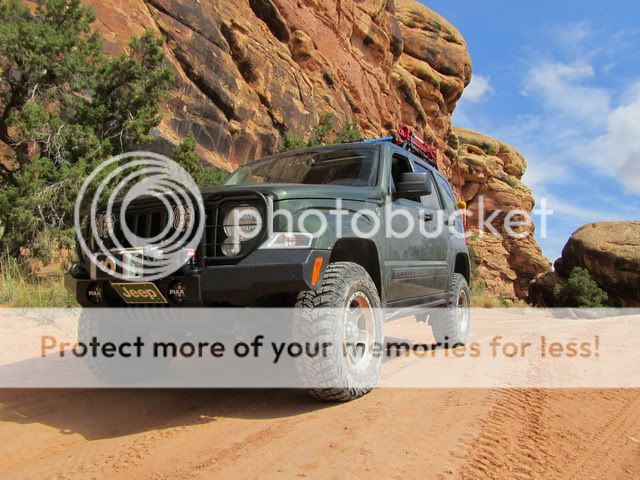

Ok, for those that have followed this entire thread and/or already get out and wheel their KK, you probably already understand why you want maximum approach clearance (at the front) and departure clearance (at the rear) in line with the wheel path. The wheel path is critical because when wheeling, you generally want to put your tires up on the obstacle for multiple reasons, including so you know where it is, maximize underbody clearance and to help protect underbody components hanging the lowest, like the rear differential, lower shock mounts, etc. Thus, if you can't get your front wheels up onto an obstacle (or to the ground when coming off a large obstacle or decline descent) without your bumper contacting, then your Jeep body (e.g. bumper) is going to take some damage unless you retreat, can avoid the obstacle, etc. Ditto for the back end, although it typically doesn't keep you from getting up onto an obstacle, or down off a large one, as the front could constrain you (since most people wheel driving forward :wink: ) thus the rear is more likely to take a hit coming off an obstacle that you were able to get up and onto (or come down off of if sizable decline). So, enough background on why clearances in the wheel path are critical...now for some photos of my Fully Armored KK making use of its high wheel-path approach and depature clearances while wheeling out in Utah this past May:
First up, crossing a small crack, first using approach (front) clearance, then getting clear with depature (rear) clearance (taken from Klondike Bluffs' trail):
Don't try this with an OEM bumper -- only my maximum approach clearance bumper and radiator/PS cooler skid plate can do this without any contact to the rock.

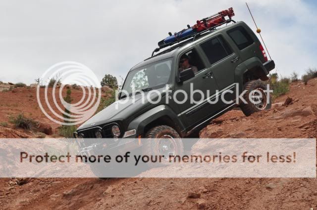

Now time to climb a little ledge on the trail....
..first getting one front wheel up on it....
...now both front wheels up on, so now to move forward...
...to get the back wheels up on it....
...now that fully up the ledge, time to move on forward on the trail. :JEEPIN:

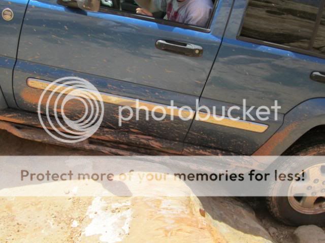

MtnLuvr wrote:
METCRD shows why rock rails are a good idea on rocky trails.
After audiboy86 provides a little tug backward to get METCRD's KJ unstuck from high centering (again, skid plates another need when rock crawlin') so ihatemybike can add some rocks to help METCRD clear this obstacle. ihatemybike (yellocoyote's husband) was great about jumping out to offer spotting when required.
