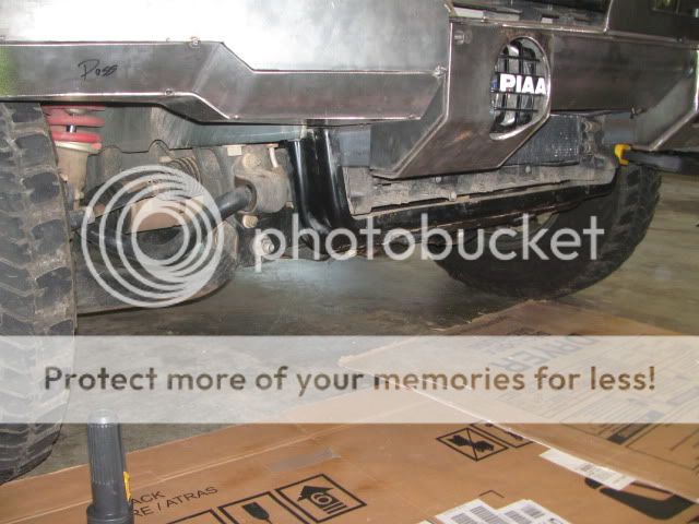

As promised, I made up a little side by side photo comparison to show and quantify how much my front winch bumper design increases (approach) clearances over the OEM KK bumper. I am able to do this because before I took off my OEM front bumper, I made a cardboard silhouette cut-out of the KK's OEM bumper profile at approximately the inside of the wheel path (and at a spot I could realign with on the grille after I had my new front bumper designed).
Below is the photo collage I made showing the cardboard bumper profile I made of the OEM KK bumper and then in the lower photos how the OEM KK bumper profile looks versus my off-road front winch bumper design (and in-process prototype).
Just all the air gap alone in the side view showing my off-road winch bumper makes it pretty obvious that my design will gain notable clearance up front, in critical line with the wheel path, to help with approach angle to get up to and/or on top of obstacles.
Here's a close-up of the side view of my front winch bumper versus the profile of the OEM KK bumper which quantifies clearance gains:
Increased clearances of:
    A = 8 1/2" (note: this does not include the little black air dam which I had removed a long time ago)
    B = 5"
    C = 3 3/4"
    D = > 3 /2"
    E = nearly 2"
    FYI, F = 8" (hang-down below bottom of the forward facing turn signal)
I worked my design a lot, which added some additional surfaces and complexity to it, in order to maximize these clearance improvements over OEM. As you can see from the Front View in the first photo, the clearances would only increase the closer to the outside of the bumper you go (but conversely, the clearances decrease as you go toward the center of the front bumper in order to have enough room to mount a winch, which is why I mounted my winch up high).
:rockon:

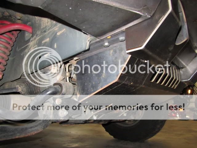

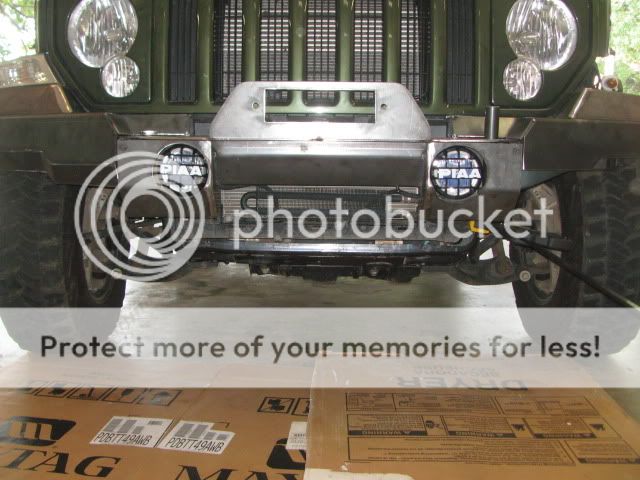

DirtyKK wrote:
would you happen to have a pic of the front bumper with the skid removed?
And I thought you weren't into my front bumper design much :wink:
Here's a couple photos of my front winch bumper with the OEM radiator skid plate:
Nearly all of my friends and family that saw how exposed the lower portion of the radiator and the power steering cooler was with my high-clearance front winch bumper design asked me what I was going to do to better protect these exposed, vulnerable-looking components. I didn't yet have my radiator skid plate design worked out, but it is now as you can see in my original front bumper posting and in the below:
My radiator skid plate design provides the same amount of access to the oil filter as the OEM radiator skid plate back mounts do (as Boblemoche asked :) ), yet provides better, and tapered skid-style, protection for the lower portion of the radiator and the PS cooler. Like I mentioned in my original front bumper feature posting, now that I've got the geometry of my radiator skid plate worked out, it is easy for me to offer several difference styles with different computer-cut patterns at the front (and I've got lots of ideas :twisted: ).
