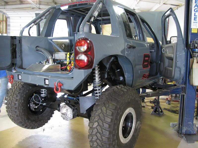

Cherrie 274 wrote:
This picture the springs are stacked, in the middle.Image
No the spring is not stacked in that photo
Those are two springs one on top of one another
some early models were that way to achieve the height and correct weight
I've not seen that done before. But then it really is stacked :), but meant to be. It confused me because that's not how I'd think springs to look.

Cherrie 274 wrote:
This is one way to get the spring rate and performance you want from a setup Cherrie. For example you could have say a 450 lb spring on the bottom and 400 on top, The 400 would of course flex faster than the bottom one creating the lift and the ride you want. Its all calculated on lift, weight of the vehicle, etc. Its one of the reasons JeepinByAl has a whole bunch of various springs with different rates piled up from testing to get the right setup before any were sold.
