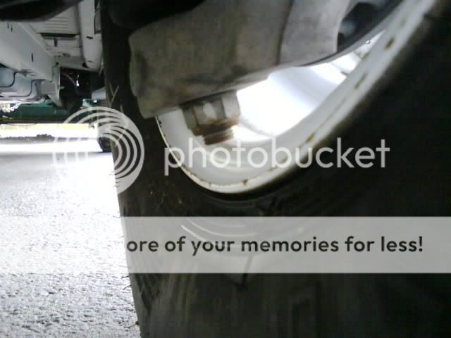

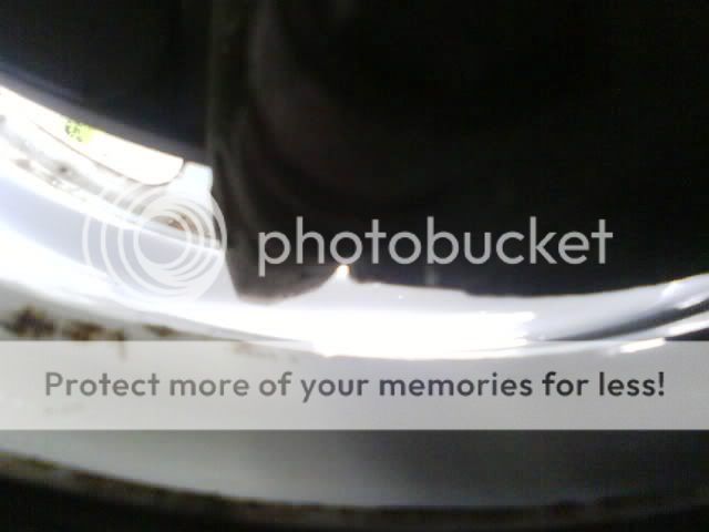

First4ce wrote:
Hello Gents!
if anyone has switched from stock rims to 15" steel, effective tire outside diameter with a 2.5" lift, and anything else we can find. You guys have been there/done that so let's get going! :JEEPIN:
15" rims won't work safely on your KK. The calipers are just too close. Here is a Pic of a test run I did using 15" steel wheels from my XJ Cherokee. I own a KA but the KK has the same calipers, and also shares many of the other suspension parts.
I had my small wife push and pull on the top of the tire, while I was watching from under the rig, and the distance between the caliper and rim closed by 1/2 way. Just not safe...
